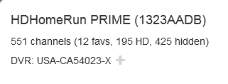

Although it shows 551 channels for my Prime, that's just how many are in my subscribed package.
Channels won't show the DRM channels and I have 425 hidden, so in reality there are 126 channels in my Channels guide.

If you click the pencil icon next to your HDHR in the Channels DVR web UI, it will popup a window with your channels and at the top it will say how many are hidden. In my case 425 of 551 channels are hidden (disabled).
