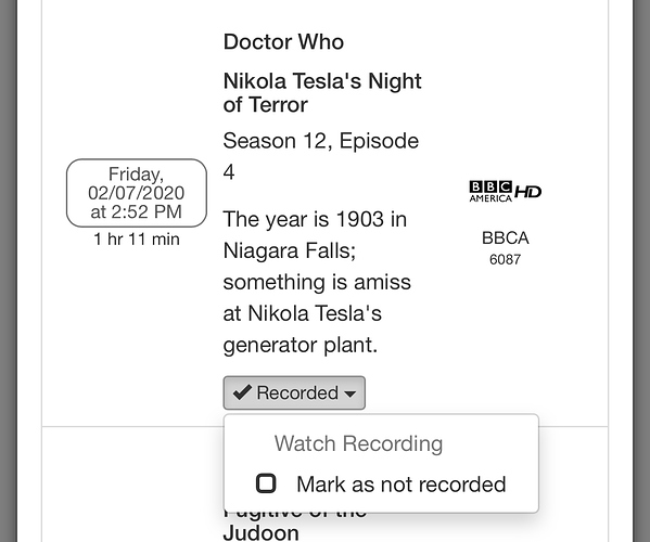

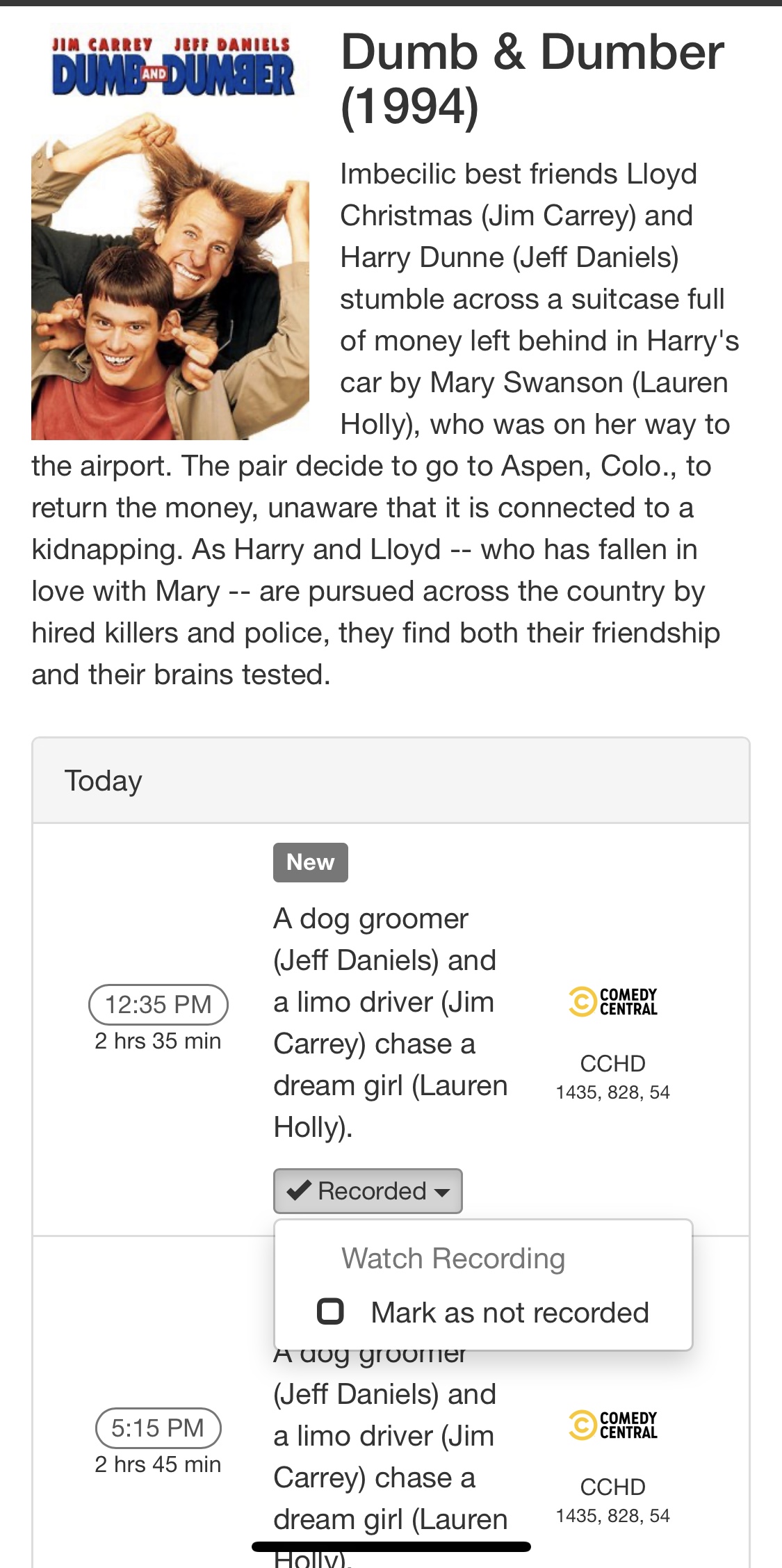

Find a new airing of the program in the guide. Click on Program, click on the "recorded' button, select "Mark as not recorded" then delete the old recording.

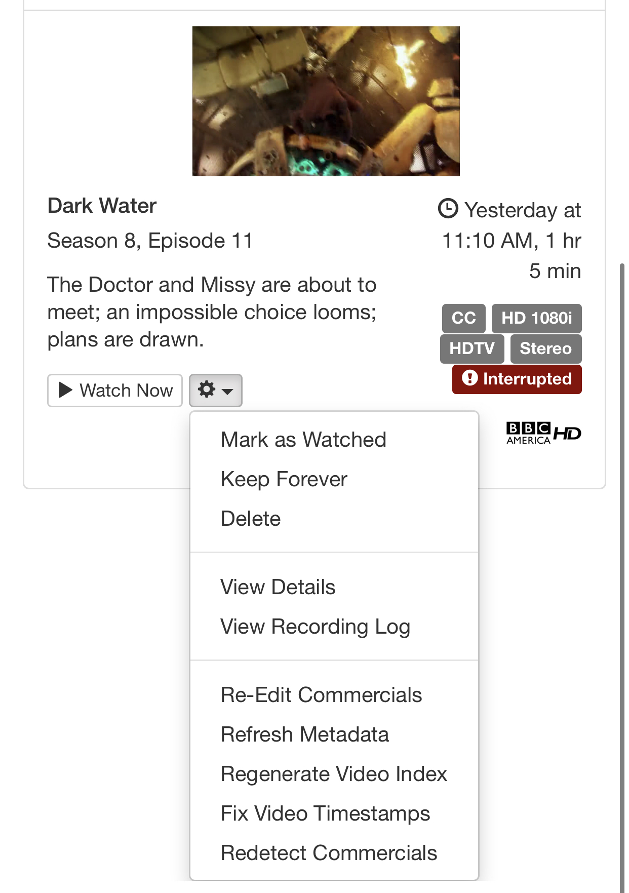

The interruption does not necessarily mean the program didn't record. Sometime the DVR may recieve a glitch in the signal due to commercial transitions. The program will playback as normal. Just look at the "view details" and look at the info like duration. Also you can "edit commercials" and look and see the recording.

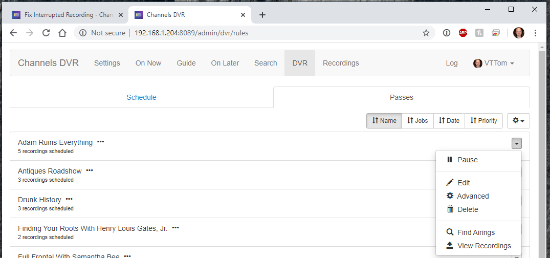

There's a setting in the Pass itself to allow it to re-record deleted recordings. You need to:
  1. Bring up the webpage for the DVR server (eg: http://:8089)
  2. Click on DVR->Passes
  3. Find the pass you want to edit and click the upsidedown triangle to the right and choose "Advanced"
  4. Check the box next to "Re-record deleted episodes"
You also have to make sure that your Pass is setup to record all not just new episodes.
I believe you can go to the web ui and select the recording in question. Check the option In the drop down box to re-record deleted episode and you’re good to go.

The only place I could find is under DVR passes. I could select a scheduled recording and it it says recorded the. I could choose checkbox not recorded. I was hoping for another way. Now I have to wait until it comes up and remember to set it.
Mine will show the next show below the one I have recorded. Can you just select the next recording and schedule it?

You need to navigate to this screen/tab in the DVR's web UI. Find the pass you want to modify, click the triangle and choose Advanced...
And then you can get at the re-record option...
