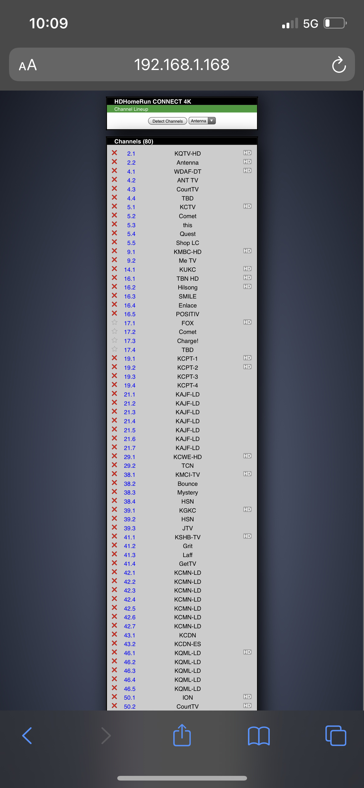

I think you might be misunderstanding how it works. The channel list is still coming from the HDHR, based on the channels it finds during its scan. You can confirm this by viewing its web interface directly to see if the channel is listed there (my.hdhomerun.com). If it’s able to tune the channel, it should appear in Channels DVR as well. Maybe you can share some screenshots of where it seems to be missing?
Rice, thank you, that worked. It still wasn't showing up there, but the favorites I selected through Channels DVR were there. And more importantly, there was a way there to re-scan channels and 5.1 popped up.
Thanks for pointing me to the right page.
Cool. If it didn’t catch it on the first scan you may need to adjust antenna. You can while tuned the channel see signals under tuner status tab. You may also need to rescan source in channels settings
