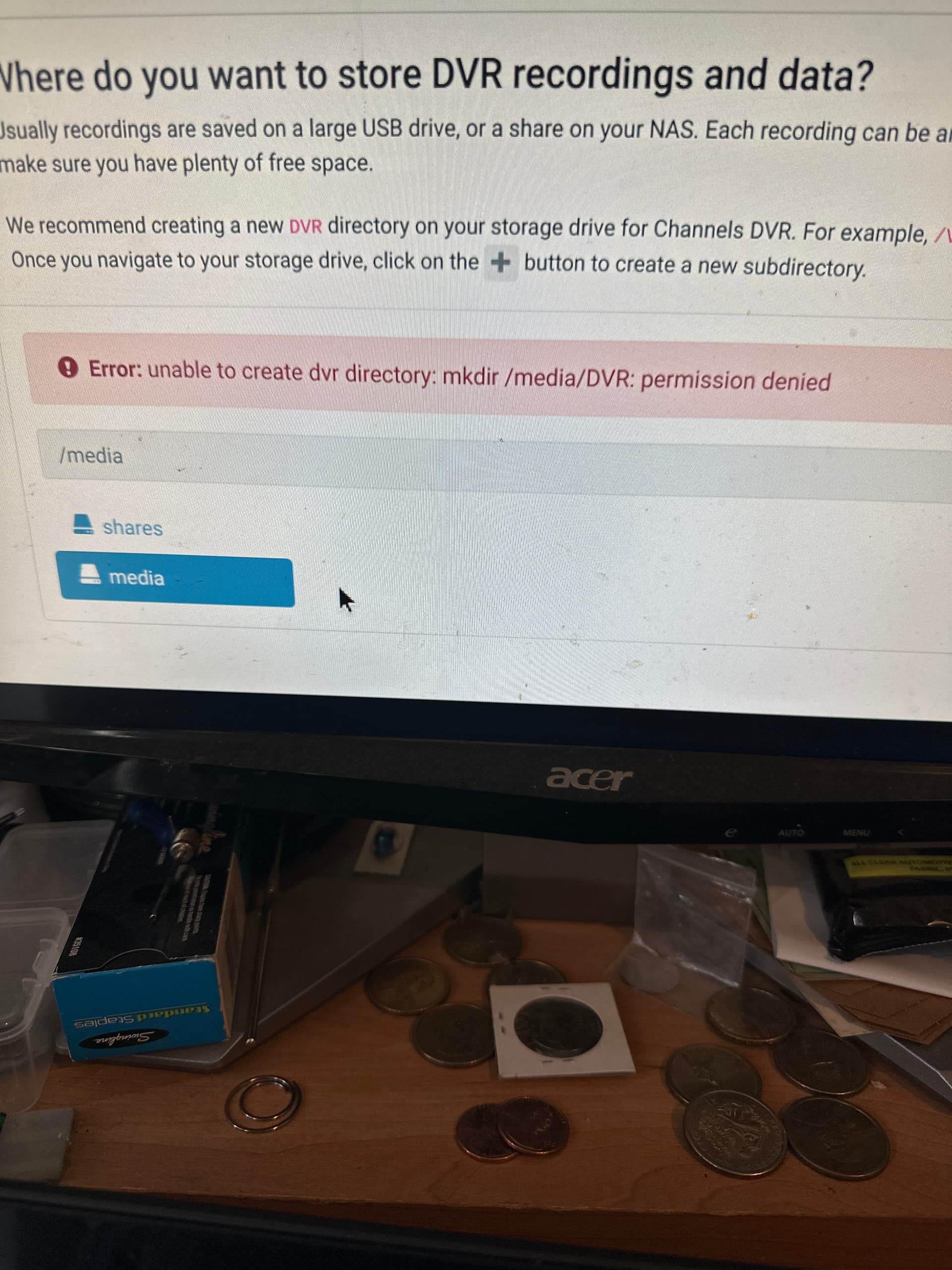

Followed directions exactly and RPI wont let me finish set up
when selecting storage path I get no write permissions to dvr directory or mkr /media/DVR permission denied......you guys make this extremely hard for people i swear

This permission denied error happens when the drive didn't get partitioned correctly. That happens on first boot, and sometimes the first boot messes up. So the fix is to re-image so it can try that part again. The new image is supposed to have a fix so it doesn't happen any more.
