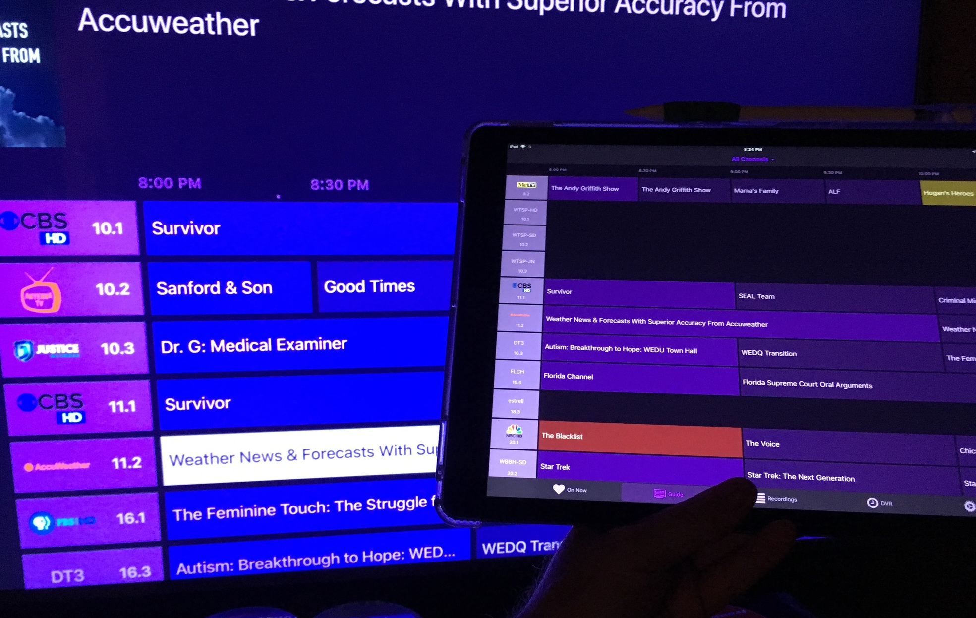

However the updated guide displays on channels DVR at random. But seems too always display the complete guide only on the web ui. Is this normal or am I doing something wrong?

ATV displays the same as iOS
However the complete guide displays at random meaning channel 10 will have complete guide data at times and at other times it displays as these examples.
90 minutes ago they displayed perfectly.

Note: channel 10 data missing on the iPad.
The guide only displays on one device.
The left devices in this image is a atv4k, right iPad Pro 12
I’ve 3 atv4, iPhone, iPad.
After performing the Invoke-WebRequest ... on the server, only 1 device will display the full guide (perhaps the 1st device to access the server?) then displays for approx 8 hours only.

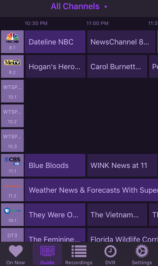

Oh and the guide is cutting out at 10pm. I’ve never seen it stop. This is what it looks like
On the DVR web ui, do the channels have the correct logos and data?
This command is using the wrong guide code at the end. The guide code should match what is assigned to your HDHRs (shows up under your HDHR on the DVR settings page). This is a different one so that’s why the overrides are not taking effect.
