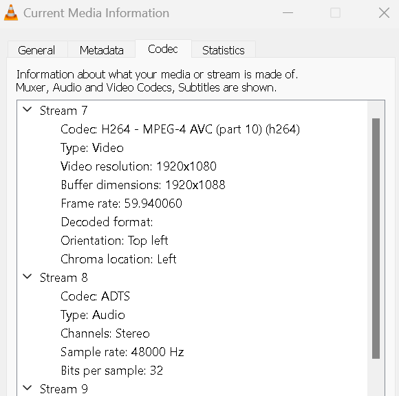

Just an update - today I’ve noticed my CBS TVE channel watching NFL this afternoon coming in at 59.940 fps. I’ve changed nothing.. so maybe the networks are? Or has Channels changed something?
CBS's Paramount+ & TVE feeds are now all at 1080/60p.
ATSC 3.0 is also 1920x1080 Frame Rate 59.940.Audio 5.1
Did this happen recently? Did I miss an announcement? Lol
CBS streams were at 1080/60p until they reverted to 1080/30p a few months ago for some reason. Now they're back at 1080/60p. I don't think anything has been publicized or announced about it.
This matches my experience. I thought I was doing something wrong. Thank you for corroborating!
I confirm that TVE WCBS switched back to 1080p 59.94fps ~10mbps around January 13th after they downgraded to 1080p 29.97fps ~5mbps at the end of November.
Nice to see they are back to better quality.
