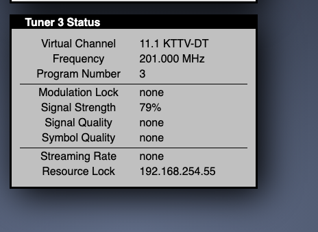

I also opened a ticket with Silicon Dust, but thought I'd check here too. A couple days ago we lost Fox 11. The antenna didn't move and no settings were changed. I posted a screenshot from my HDHomerun settings. When we go to the Channels in our DVR, the station just says Weak Signal. Any suggestions on the Channels side, or is this strictly a HDHomerun issue? Thanks!

The bobcat fire is getting really close to the LA antenna towers on Mt. Wilson... could impact many channels if they aren't able to hold it back. https://deadline.com/2020/09/bobcat-fire-in-los-angeles-containment-falls-flames-threaten-mt-wilson-observatory-tv-towers-1234577104/
interesting thought... wouldn't that affect the other stations with towers nearby as well?
Last night I was having trouble getting univision 34 and unimas 46 here in Corona, CA "near LA" my parents had to get me to look into this and figured it was cause of the fires. We just started getting the signal again a few hours ago
The transmitter power levels had to be lowered while firefighting operations were going on close to the antennas.
