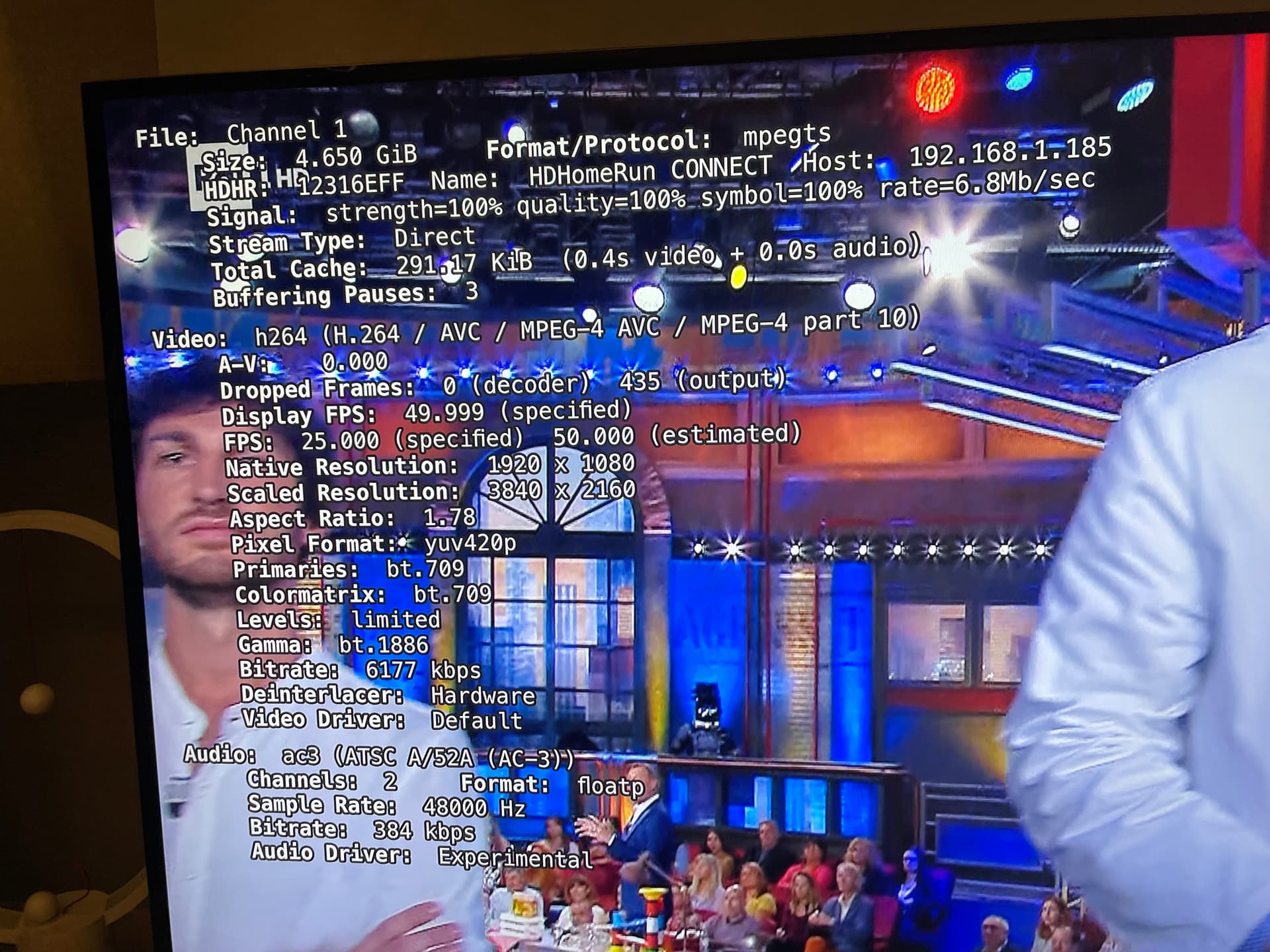

I've just sent a new diagnostics log with frame drops using experimental audio driver.
I've been searching for a setting that would let me turn this stats overlay on. Please share how to enable it. But, if it is coming from HDHomeRun, then I don't have that. Was looking for an AppleTV function.
While watching a video on your Apple Tv, press the DOWN button on the control dial. It'll bring up "Info and Options". Now, press the RIGHT button, to go to "Options", then press "Down" then "Right", then "Down, Down" to "Show Stats" then press the Center button to select them and bring them up. Then press the "<" back button below the control pad to get the info screen to vanish. That'll leave the Specs screen for you to look at.
Do the same steps and Uncheck "Show Stats" to make it go away
This issue is still occurring and is very noticeable when watching something like the news that has a ticker tape/scrolling text at the bottom of the screen. Every few seconds it changes from smooth playback to a small hiccup and if I have the specs on the screen, I can see the dropped frames (output) increase at the same time it occurs.
I have the latest gen Apple TV 4K running tvOS 15.6 and Channels app 5.5.3
It occurs when watching a recording of an ATSC 3 broadcast with 1280x720 native resolution and 59.940 FPS. I've tried both the legacy and normal video driver and both have the issue. I've uploaded my diagnostics (but not sure where it went/how to identify which logs are mine)
