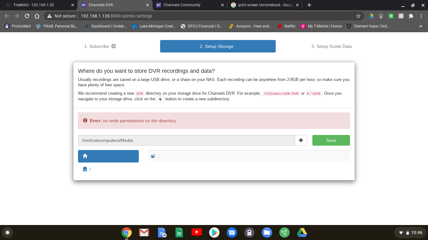

I have installed channels on my Freenas 11.3 . The problem is I try to setup my storage and I already have a pool called media and dvr folder in there . User is set to nobody and group set to guest. Try to set my storage to my dvr folder and tells me don't have permission. What am I doing wrong?

On my linux server, Mint 19.3, i had to give the "Channels DVR" system user read/write permissions to the storage directory. (don;t recall the actual username u need to use, you can find in the setup directions for Linux)
You can not use Guest permission, as I think those are read only.

The issue clearly is a permission issue, as the error message states.
What is the correct working permissions that needs to be set in FreeBSD for Channels to work then eh?

FreeNAS uses FreeBSD's jails, which are similar to a chroot, but still different. A closer approximation might be LXC or systemd-nspawn containers, but neither really fully equate. Also, the filesystem is most likely ZFS, which introduces a few additional wrinkles.
Yes, it looks like an easy permissions issue. But the underlying foundations and file systems are different. If you don't even know what FreeNAS is, why are you chiming in?

if you type id dvr in shell you will get the following :slight_smile: ID=820

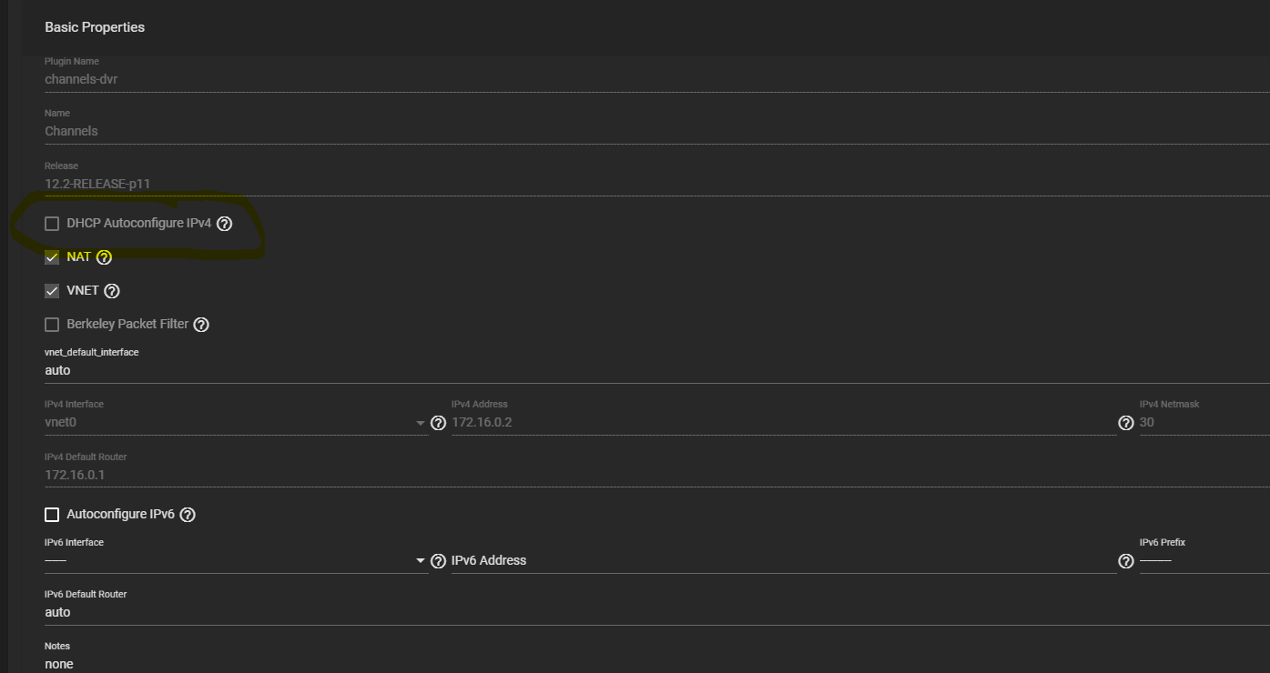

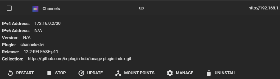

Now I seem to have a different problem, even after setting the mountpoint and giving the user access to the share I can't login. When I go to the page I get the login prompt but then I get redirected to a different IP address. http://172.16.0.2:8089/auth/confirm?code=c5a036a4868a62c29f99470fa2360b571044f9891a905145e60db24799fb67ad
This seems to be the issue and now I just need to figure out where to change the setting.
This was the issue set it to DHCP and all is well :slight_smile:
