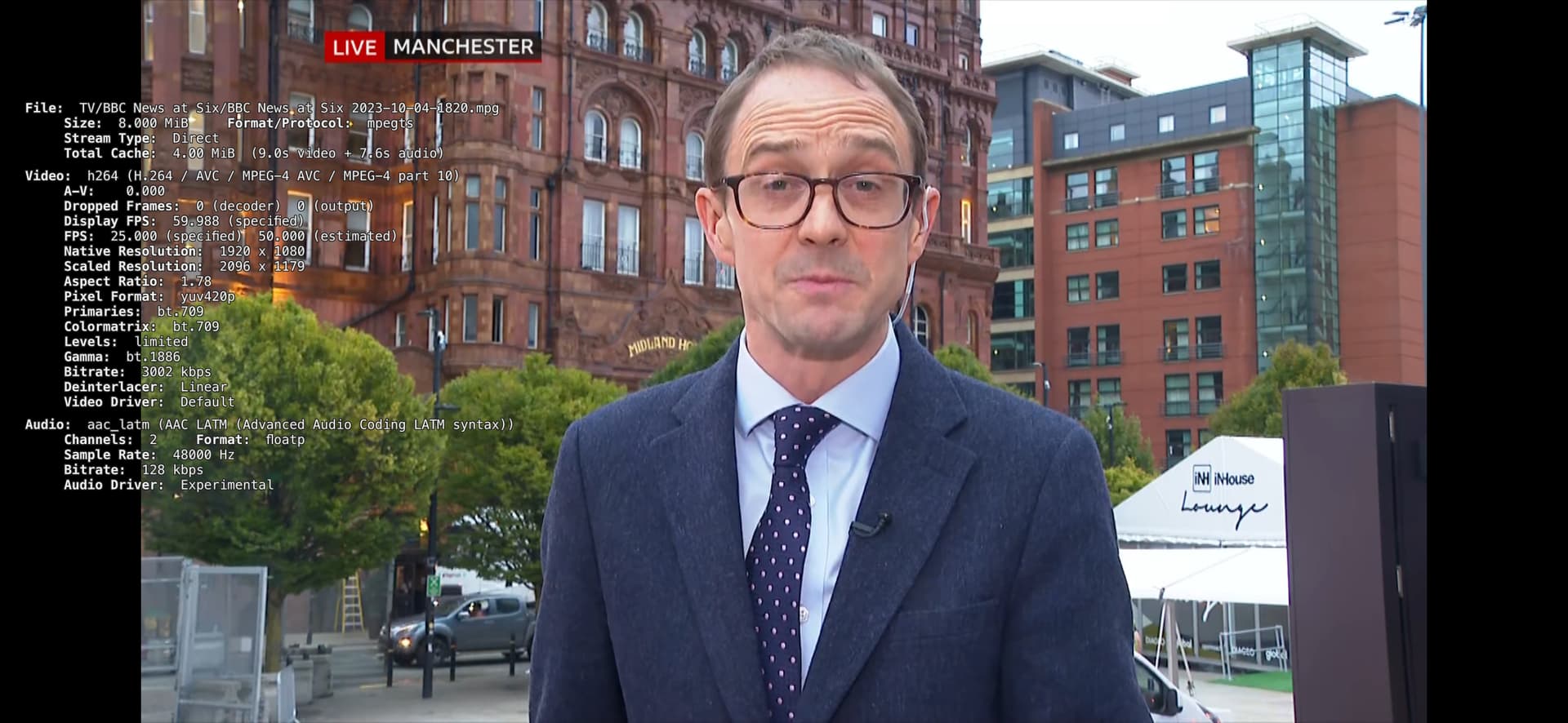

What does View Details show for a recording off freeview
Here is an example of something that would play as Dolby Digital on the Sonos when watching directly from the LG tv.
I believe it is normal for Freeview HD TV to transmit surround as encoded stereo and expect the end devices to upmix / decode the surround channels. Not ideal, but I think that’s how they’ve got around a limited bandwidth so they can provide stereo and surround in one.
It is quite rare to get something transmitted as discrete surround on Freeview. It does happen, and those do play as Dolby Digital.
