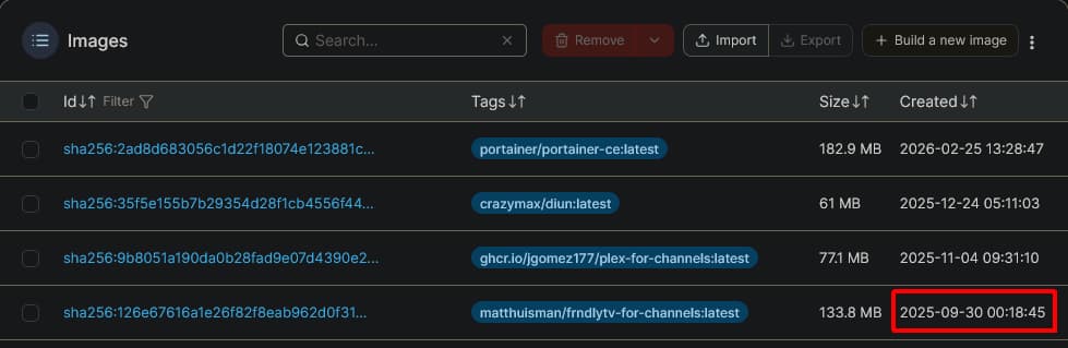

Check the Frndly TV container log
Also the one other thing about this project is that it is hard to tell which version you are running. I know it was updated 5 months ago to include West. I guess you would have to go by date of how long ago the project was installed/updated last too. Maybe on an old stale version?
I have a few containers like that.
I compare the image creation date/time (view in Portainer)
with the date/time from the image repository matthuisman/frndlytv-for-channels - Docker Image

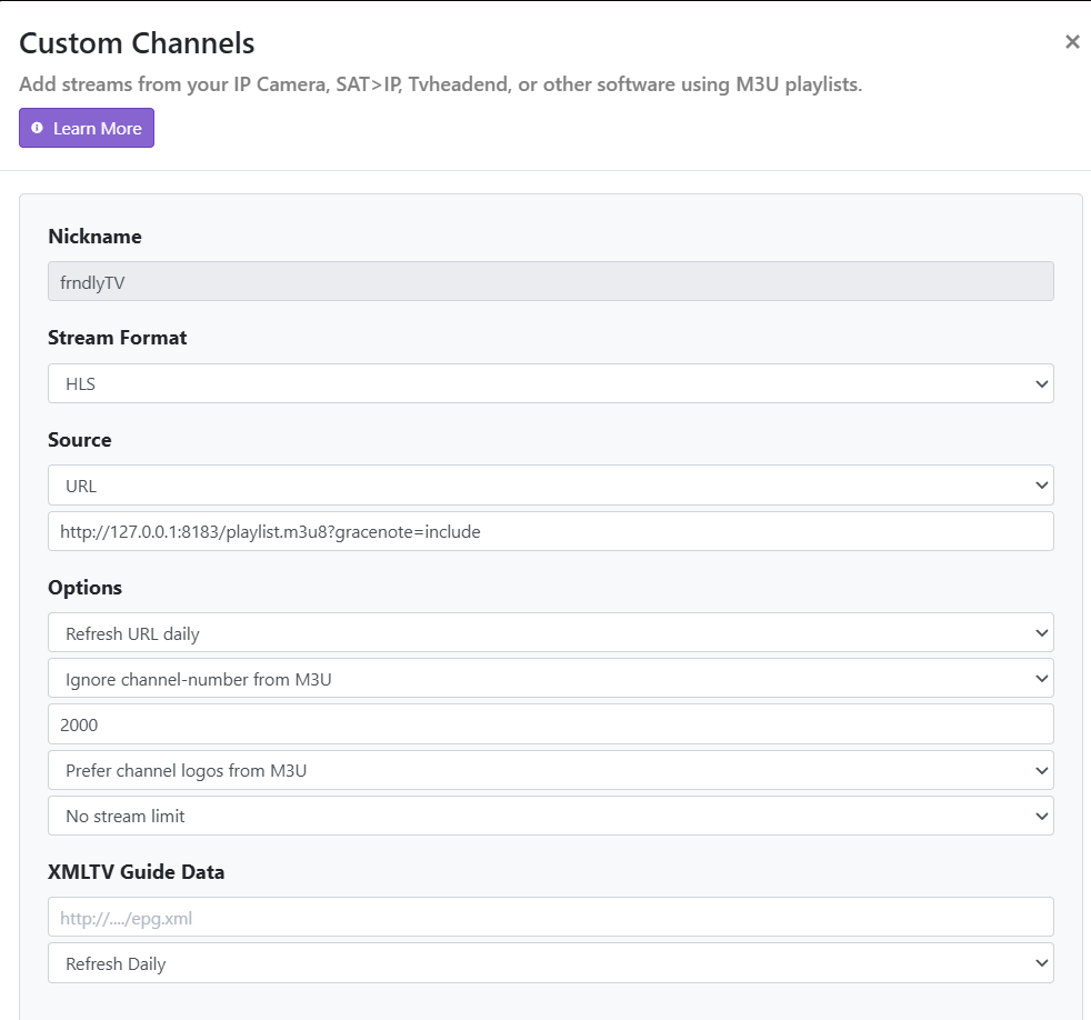

Trying to use the the urls in two atempt to add custom chanels. First has no XML, the second has borth guide url and epg url. However neither works, throws error and cant be added.
I changed frdly paasword to recheck. Emaol Name and password work fine longing into frndly on web and in their app.
The only thing I can think is username is not the l9gin email??????
I have a year sub. Been using this for a long time. Was working the other day, but I am I have been seeing this message more on more even for items I play from the hard drive. this is when I tried to watch a live show:
I looked at my environment variable for username and I used my e-mail address. I would think the free 7 day trial should work.
Here is what I use for channels setup. But I bet you have to have a valid login in order to get anything to show.

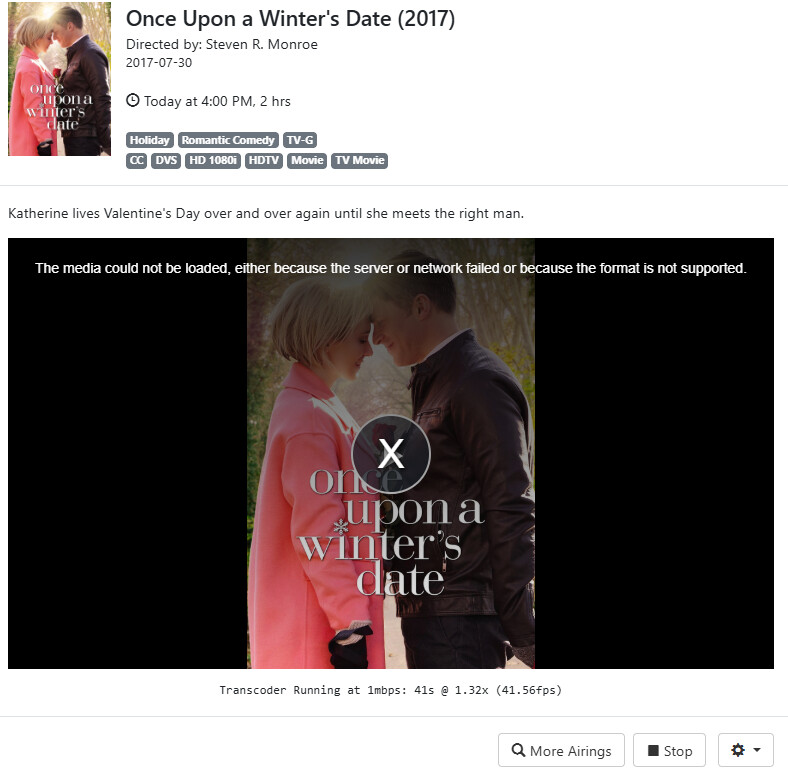

If you are having the same error when playing from a recording then I don't think its frndly that is the actual issue. I know from the browser everything has to be transcoded and maybe its not fast enough to do so.
That's been going on for months with browsers based on Chromium:
Use a browser not based on the Chromium engine, and it should work.

Here are the dates of the Commits that was done on frndlytv-for-channels.
Yep, those are his github commits.
I look at where I'm pulling the image from because they aren't always in sync for all the containers I use.
https://hub.docker.com/r/matthuisman/frndlytv-for-channels/tags
Some developers update the container image but not the github commits
So you get notified of a new image available, but no updated commits or release notes
