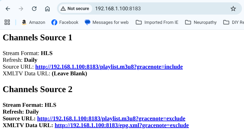

My Channels sources are as follows: (use your own server IP address and Frndly port)
Channels Source 1
Stream Format: HLS
Refresh: Daily
Source URL: http://192.168.1.100:8183/playlist.m3u8?gracenote=include
XMLTV Data URL: (Leave Blank)
Channels Source 2
Stream Format: HLS
Refresh: Daily
Source URL: http://192.168.1.100:8183/playlist.m3u8?gracenote=exclude
XMLTV Data URL: http://192.168.1.100:8183/epg.xml?gracenote=exclude

I'm fairly certain that both the docker and python methods follow the same format for configuring Channels sources. Try browsing to your server's ip address using the port 8183. You should come to a page like this. It identifies the info to be entered for your DVR custom channel sources.
