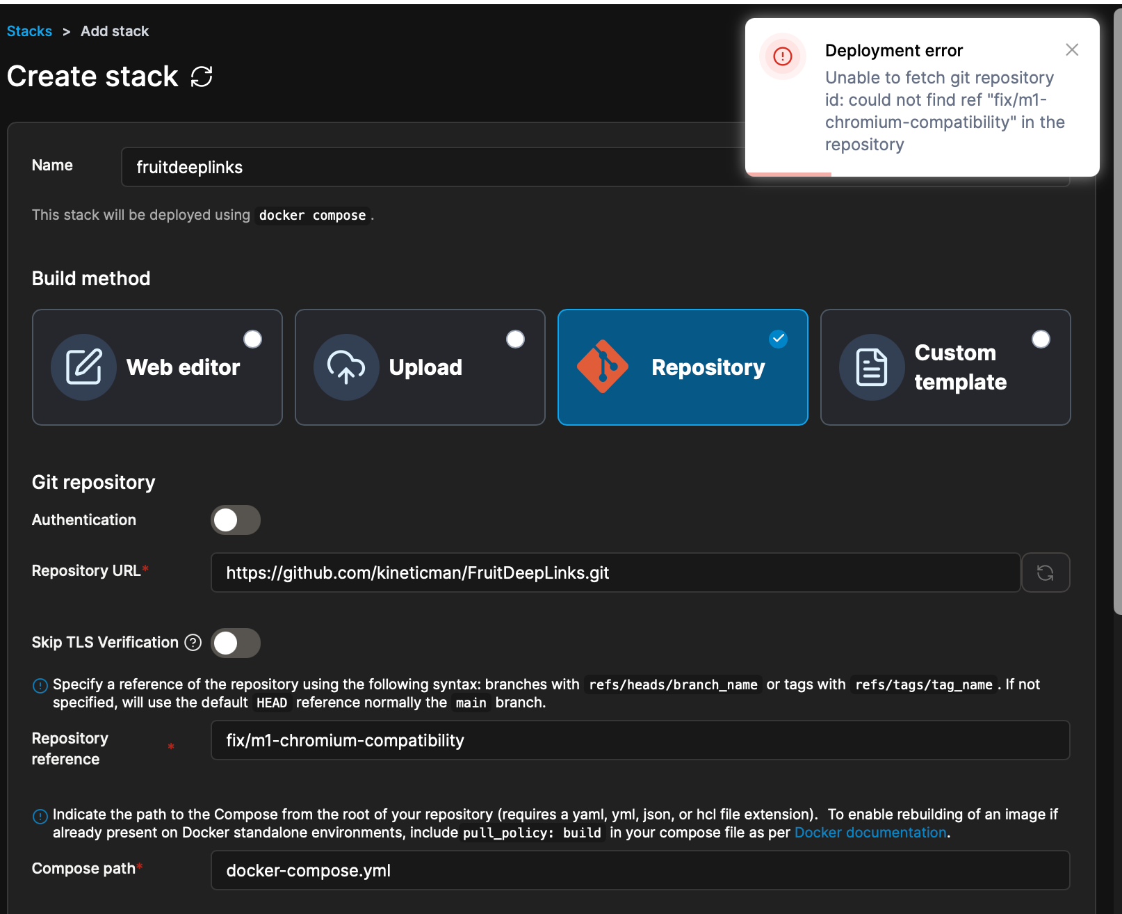

Thanks! I just tried but got an error... can't figure out what I'm doing wrong here:
In Repository reference, use:
refs/heads/fix/m1-chromium-compatibility
Thanks! I tried deploying now and got further along. This is the next error:
Deployment error
Failed to deploy a stack: compose up operation failed: Error response from daemon: mounts denied: The path /data/compose/55/logs is not shared from the host and is not known to Docker. You can configure shared paths from Docker -> Preferences... -> Resources -> File Sharing.
See https://docs.docker.com/go/mac-file-sharing/ for more info.
I can follow the instructions to add and mount a share but what should I name that directory and where should it be saved?
looks like a problem with absolute paths that docker/porttainer cant access. try this docker-compose.yml (make sure u edit your username!)
