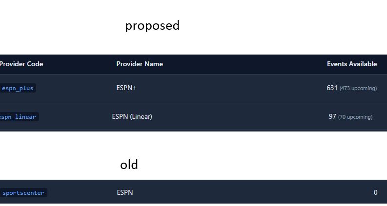

thinking more about the ESPN issue-- curious your thoughts everyone.
right now, when an event is ESPN/ESPN2/ESPN NEWS/ESPN Deportes/ESPN+, it all gets lumped together into ESPN.. should I seperate them all out into unique providers, or continue to lump together? i suspect the issues we're seeing is the lineral events are tough to get to auto-play the deeplink. If I sepereated them somehow, we could easier debug, but then it might get messy for the ADB users having 5+ different espn outputs.
what if i lumped the espn/espn2/espnNews into one bucket, espn+ sepearate, deportes seperate?
open to suggestions!

yea i'm leaning that way... I did a little test what i think it should look like, but I want @bnhf blessing because it would likely break ADB for current users for ESPN setups. But that's what you guys get for being beta testers :rofl:
ESPN+ (streaming):
  • ESPN+ V2
  • ESPN Unlimited
  • ACC Extra (digital overflow)
  • SEC Plus V2 (digital overflow)
ESPN Linear (TV channels):
  • ESPN
  • ESPN2
  • ESPN Deportes
  • ESPNU
  • ESPNews
  • ACC Network
  • SEC Network
Any chance this could be done using in the Streaming Services section of Filters & Settings? So instead of only selecting ESPN as a subscribed service, one would select ESPN+ and/or ESPN Linear separately? If that's possible, and a similar amount of work, I believe the ADB integrations could stay as they are.
i think so! just to make sure- you rely on the "sportscenter" name, right?
Yes. That's the scheme used, and Provider name in ADBTuner.
Pushed update-- you can now filter by
  • ESPN Linear (ESPN, ESPN2, ESPN Deportes, ESPNU, ESPNews, ACC Network, SEC Network)
  • ESPN+ (ESPN+, ESPN Unlimited, ACC Extra, SEC Plus (digital overflow content)
  • BOTH under STREAMING SERVICES in filter page.
I made it backward compatible for ADB users (should all go under Sportscenter) so should be non-breaking.
