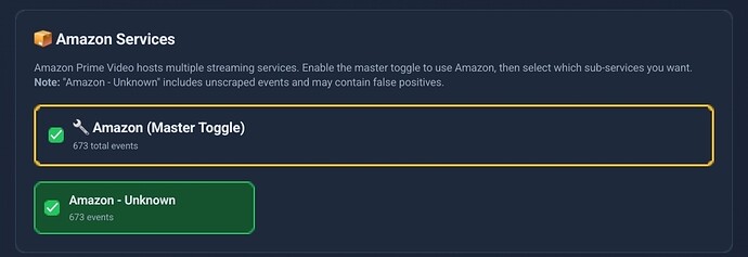

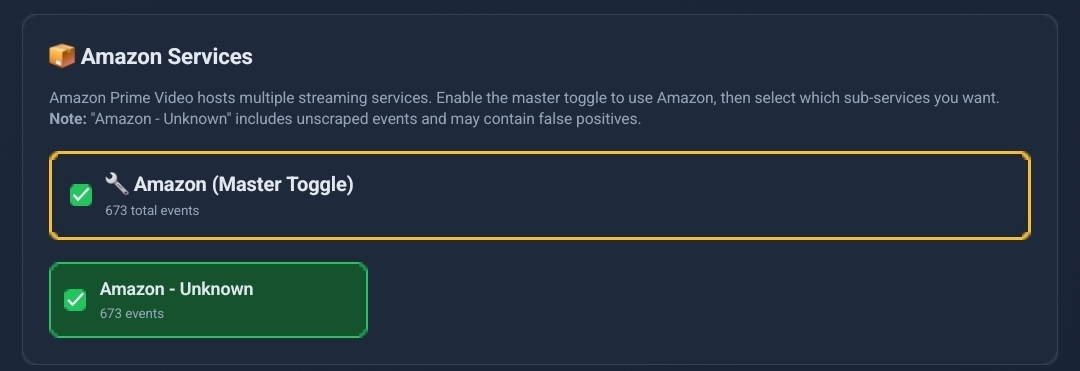

For what it's worth, I'm seeing same issue where all Amazon events are showing under "Amazon -Unknown". I am using docker compose method, pulled latest docker image from the repo (no local build).
In order to rule out any pre-existing conditions, I started fresh by deleting the /data directory, started the container and then did a full refresh.

Yeah, live logs work but I didn't think they would go back far enough, however I did see this below. Step 7e completes OK, but 7e-migrate fails:
EDIT: I did pull latest update from this today prior to this.
[OK] Step 7e complete
[7e-migrate/13] Updating Amazon playable logical services
[7e-migrate/13] Migrating Amazon logical services
MIGRATING AMAZON PLAYABLES TO CORRECT LOGICAL SERVICES (broadcast GTI join)
File "/app/bin/migrate_amazon_logical_services.py", line 291, in
raise SystemExit(main())
File "/app/bin/migrate_amazon_logical_services.py", line 287, in main
return migrate(args.db)
File "/app/bin/migrate_amazon_logical_services.py", line 183, in migrate
cur.execute("""
sqlite3.OperationalError: no such column: is_stale
:warning: Step 7e-migrate FAILED (non-fatal) with exit code 1

I see the latest push is from 12:07pm ET on Jan 29, I'm pretty sure I was using that one when I did my test. However, to be sure I wiped clean again and pulled the latest image and still seeing same error during step 7e-migrate.
Was there another update after 12:07pm ET that I'm not seeing?
