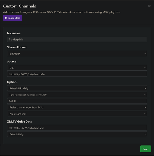

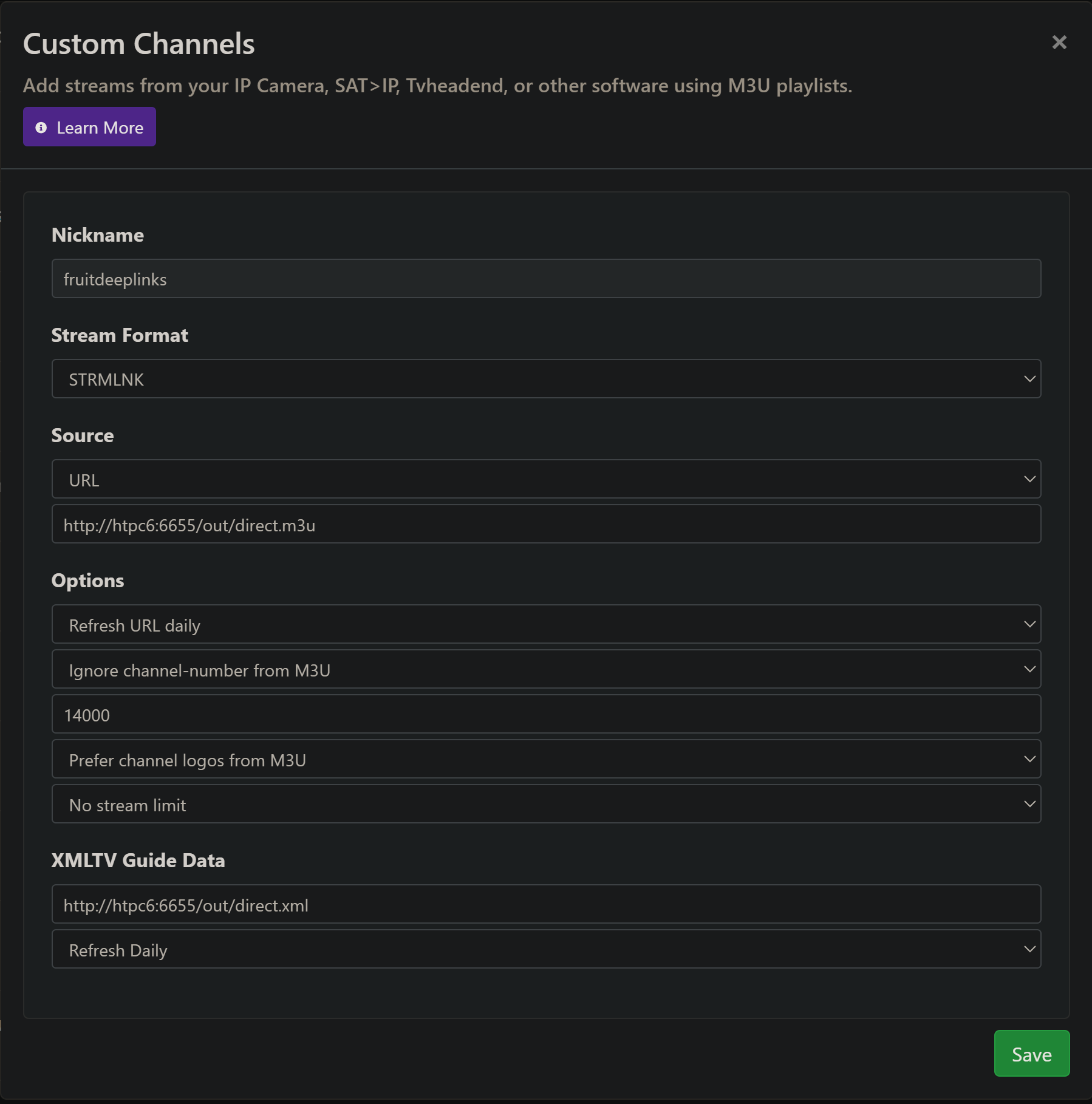

I set this up using the above compose, and this CDVR Custom Channels setup:
Only one live event atm, but it worked on a FireStick! It was an ESPN event, so it didn't jump to live (as we've seen before) -- but given it's a streamlink, one can choose to watch from start or jump to live with the remote.
I'll start the process of getting this working with ADBTuner...
EDIT: A second event is live now, and that worked too. Brilliant work @KineticMan!
