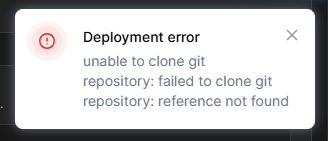

I'm struggling installing FruitDeepLinks on my Synology NAS. For those that have successfully installed it, can you help me out?
I'm trying to create a Stack like KineticMan indicates in Portainer. I add the Repository URL and ENV variables, but when I go to deploy I get:
I'm definitely doing something wrong. If you successfully installed on a Synology, send me a note!
It looks like you're trying to use a local build stack. You want a Docker Compose that'll pull the pre-built image for you:

Got it installed. I was able to pull the container within Portainer from the image link.
Now I need to tinker to figure out how to use it.
