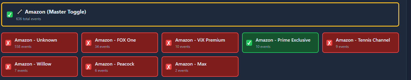

Did a wipe and full scrape and some more Amazon items are showing now. I'm thinking now it could have been a timing issue, I forgot that the items on the filters page only show up for events within 24 hours. It is also a quiet weekend for pro sports due to the NBA all star game and Olympics, etc.
I'll keep an eye on it going forward. Sorry for the false alarm.
I believe I have the Amazon scraper only to look out 2 days. Once I’m more confident in it, I’ll add more days

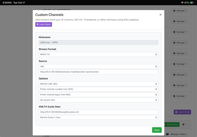

Looks like I may need a little assistance setting this up. My goal is to utilize FruitDeepLinks & ADB Tuner to play and record.
I previously set up FDL and was able to get the streamlinks to play.
I deleted all my previous FDL stacks to be able to start from scratch.
I started with @bnhf directions in post #93. I utilized Project One Click to create The FDL stack. I performed the initial scrape then configured ADB support. I'm very weak on ADB Tuner. I do know my endpoint connection was successful and the stick is Android 7. I do have a newer stick that I can swap out if needed.
I've got a custom source set up but probably wrong. I can see in the guide but can't play.

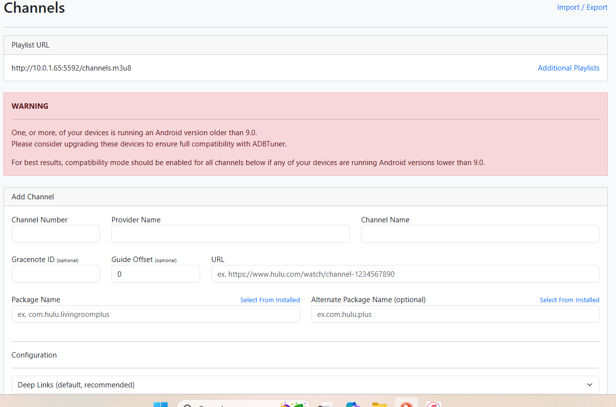

Go ahead and post a screenshot showing at least one of the virtual channels that were setup for you in ADBTuner, along with a screenshot showing your ADBTuner virtual tuners.
Also, let's see the CDVR Custom Config that was setup by Project One-Click -- and again, a screenshot is sufficient here.

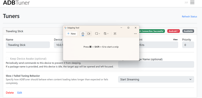

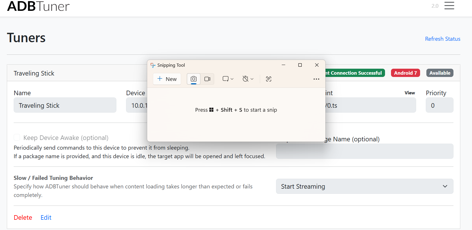

This is what I see on the ADB Tuner webui. I'm assuming this is where the virtual tuner would show
strong text
OK, so this problem #1, your streaming stick is not recognized (red rather than green color) and that means the virtual tuner (encoder + streaming stick) isn't available (blue rather than gray would indicate it's in use).
Fix these first -- and reach out in the ADBTuner thread to get this "square one" requirement sorted out. I wouldn't bother messing with a streaming stick that isn't based on Android 9 at a minimum.
Changing the stick out is the easiest thing for me. I'll change it out then post in the ADBTuner topic.

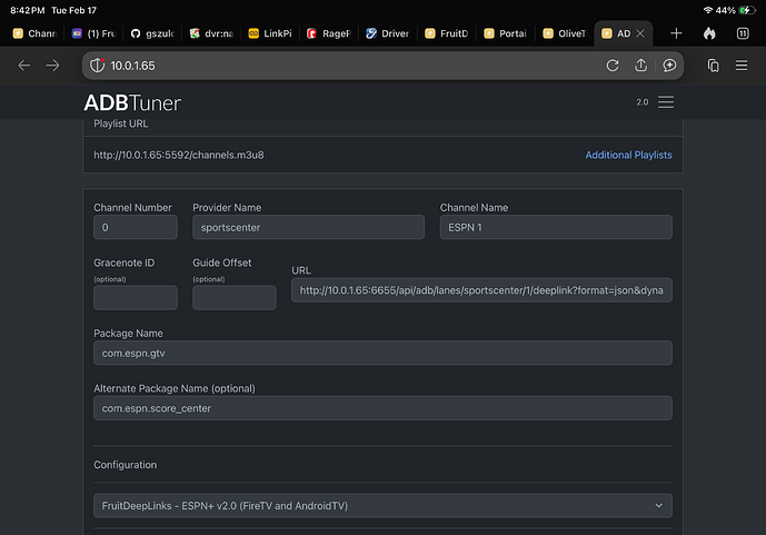

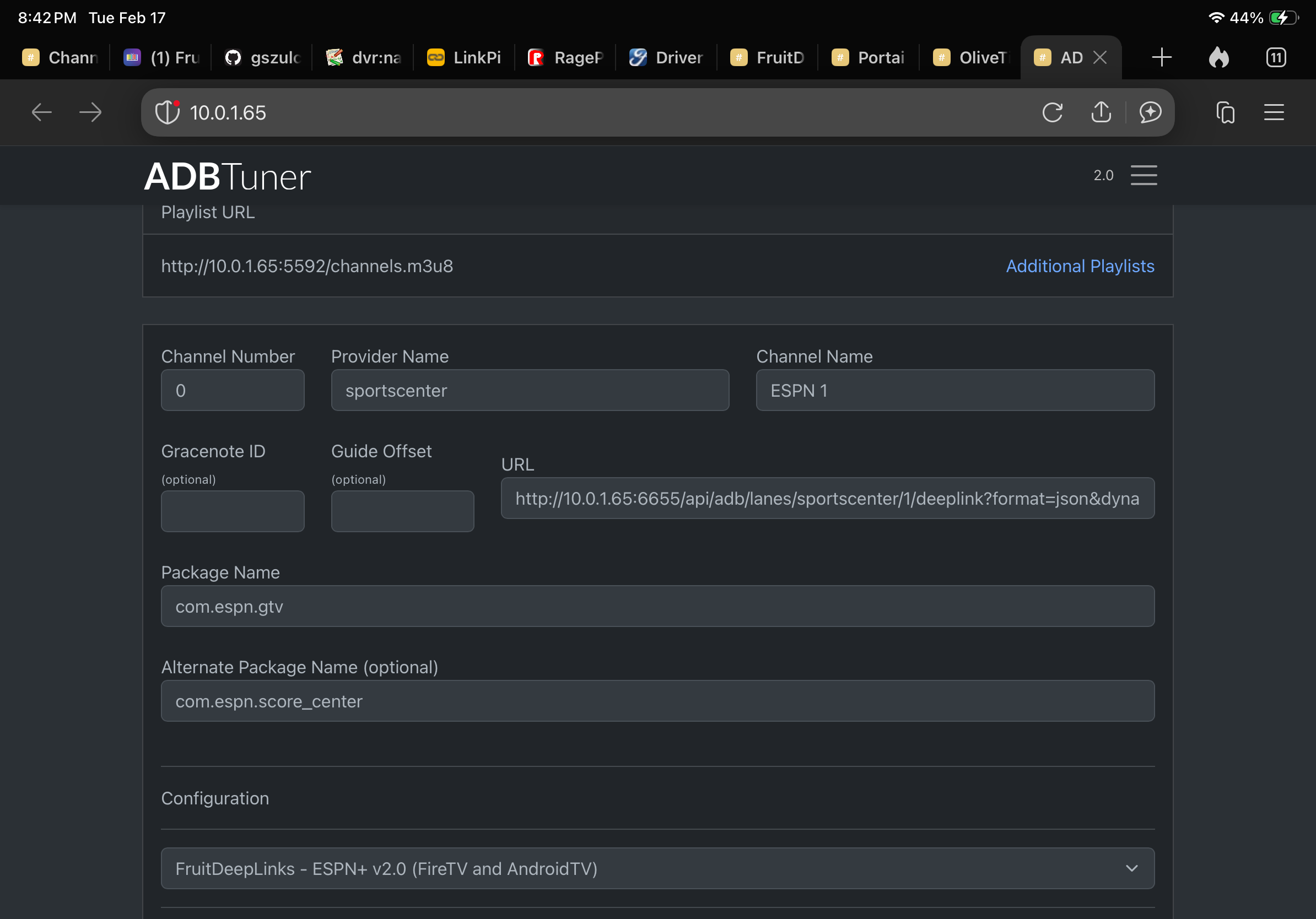

I redid the 2nd step and selected the FDL Config. This is the result. Progress.
Is 50 channels the most- I thought I selected more.
To increase channels:
Export
Edit
Import
That looks promising as well. How about the CDVR Custom Channels Source?
I forgot to screen shot before I deleted it. For some reason, I thought it was incorrect .ill recreate it.
No, just re-do the Project One-Click Action, and be sure to select FRUIT_REMOVE for the provider you want to re-do.
Found it
