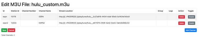

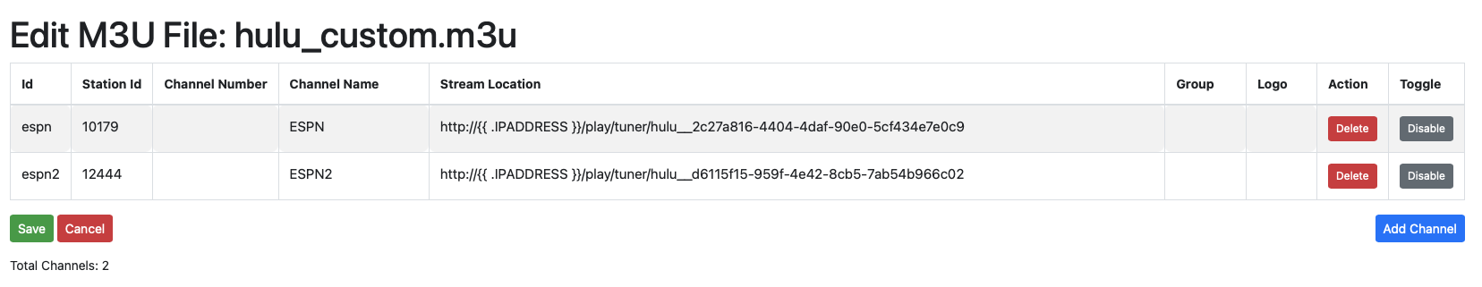

Hi @nateg Wondering what your M3U looks like for the HULU Deeplinks of the ESPN linear channels? I'm running AH4C and the Hulu M3U wasn't loading Hulu, it just opens the FireTv homepage and not the Hulu App.
Or if you could point in the direction of where Hulu Deeplinks M3U's are documented?
Thanks!
That probably has more to do with the Hulu ah4c scripts, as those date back a couple of years, and I've never tested them. We should move this discussion to the ah4c thread, and you should post the logs from a failed tune.
There is good description of it in the main ADBTuner channel. Search there. Methods to discover your deeplinks for Hulu, YoutubeTV, Sling TV, possibly others, all there.
Thank you @bnhf @nateg I'll do some more testing and move this convo to AH4C if I have further issues :+1:
