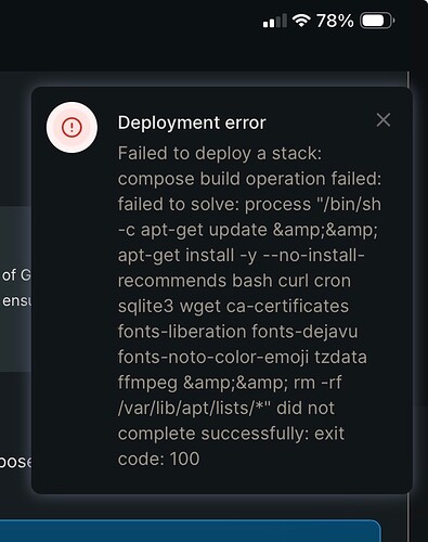

This sounds fantastic! I’m running on Ubuntu Server and seem to be getting this error:
When trying to deploy through Portainer stacks. Any ideas? I’ve double checked the ENV vars, and it doesn’t get far enough for docker logs fruitdeeplinks to be useful.
Thanks!
This looks like you're trying to build the container locally. What does the Docker Compose you're using look like?
Maybe use Project One-Click instead?
I was just following the GitHub instructions (stacks > repository > etc), so my docker-compose is the one in the repository.

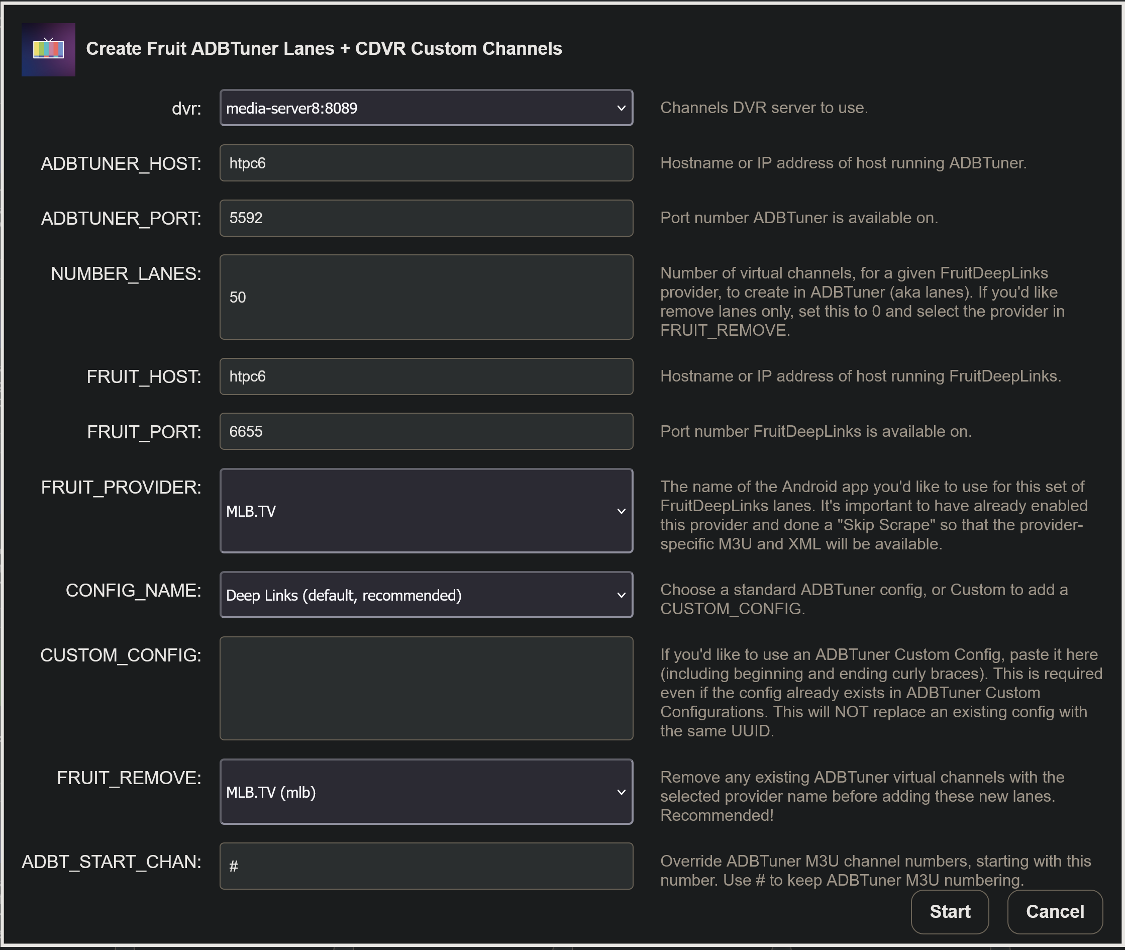

I've added MLB.TV FruitDeepLinks ADBTuner lanes to the Create Fruit ADBTuner Lanes + CDVR Custom Channels Project One-Click Action, however there's no cross-platform custom config for it yet, as I don't have an MLB.TV subscription. In the past, I've used the free game, but I don't believe that option exists anymore.
There's a generic Android MLB.TV config posted a bit earlier in the thread, though those often don't work for FireOS. If anyone has a chance to test it out -- let me know if there's a config that'll work on all platforms, as those are the ones I include in Project One-Click.

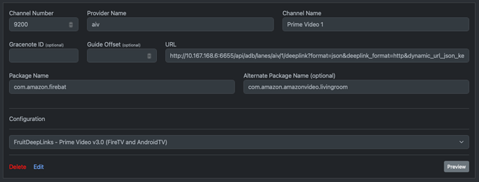

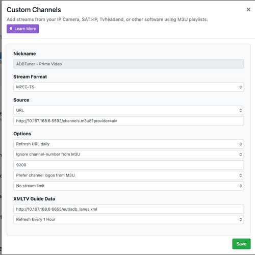

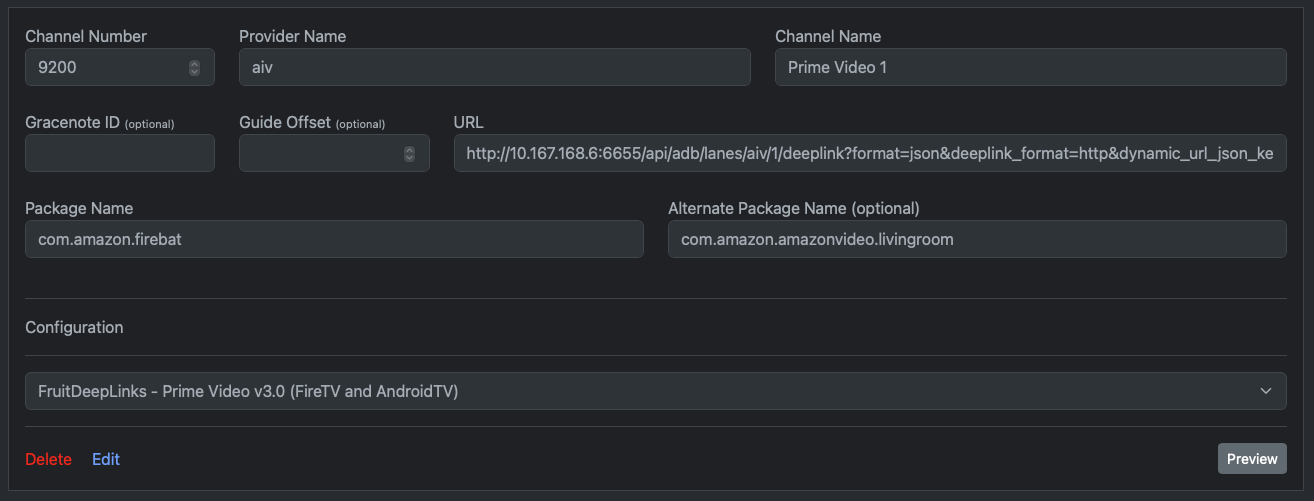

Thanks for this amazing project! I'm hoping to use it to record NBA games and Tour de France via ADBTuner on Fire sticks, especially the games that are Amazon Prime only.

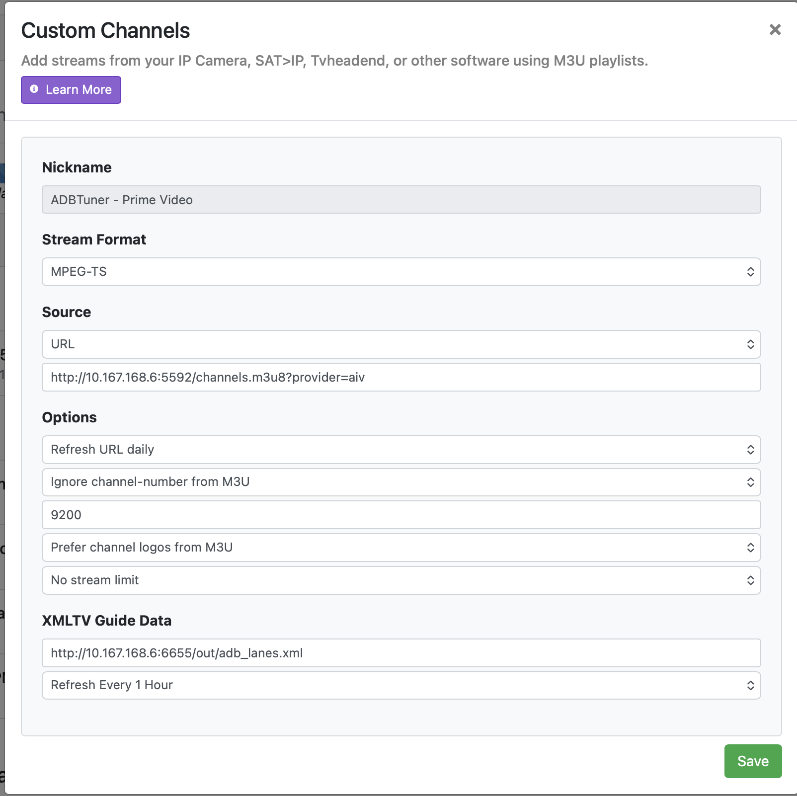

I've used OliveTin to create ADBTuner sources for Prime, Paramount, Peacock, and ESPN. However most of the events that show in my guide don't open the event on my Fire stick. I'm probably missing something simple but not quite sure what that simple thing is.
I'm also not sure if this is an FDL or ADBTuner issue so am posting here but please let me know if I'm in the wrong thread!

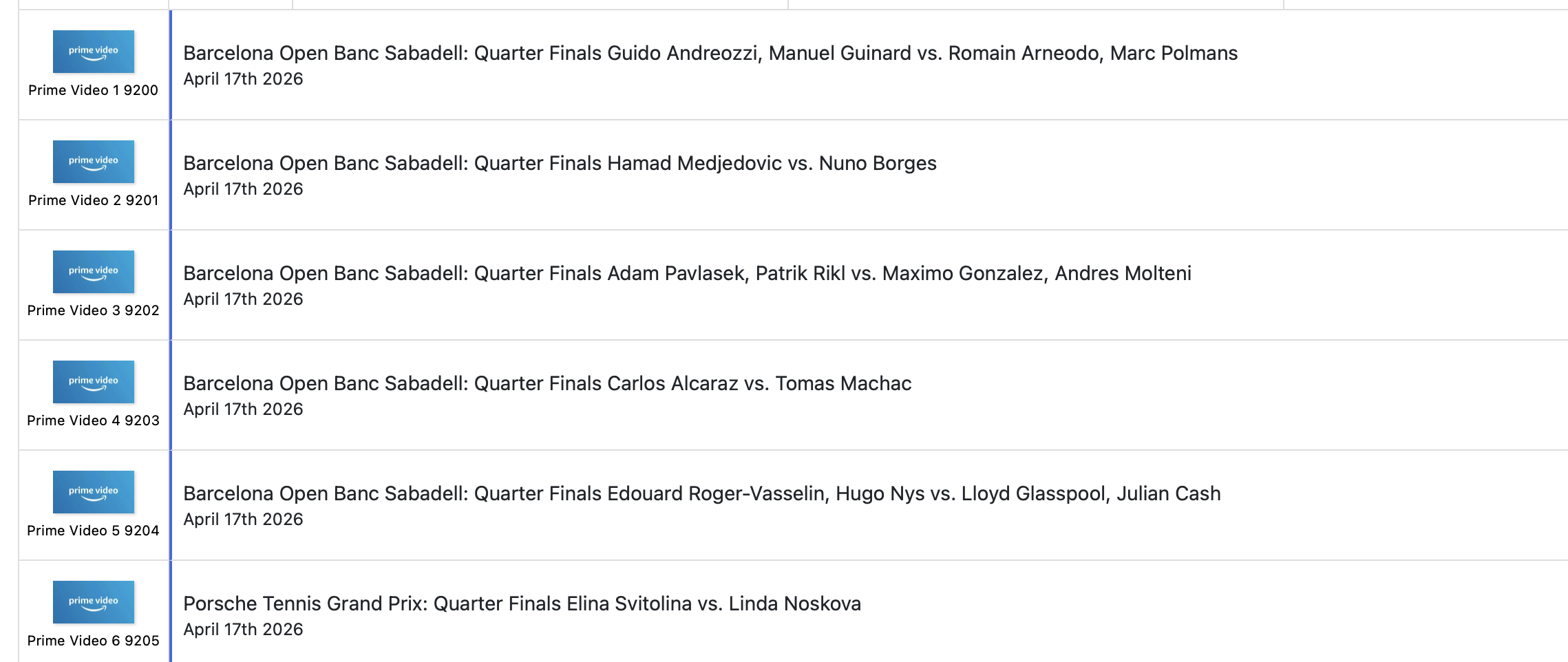

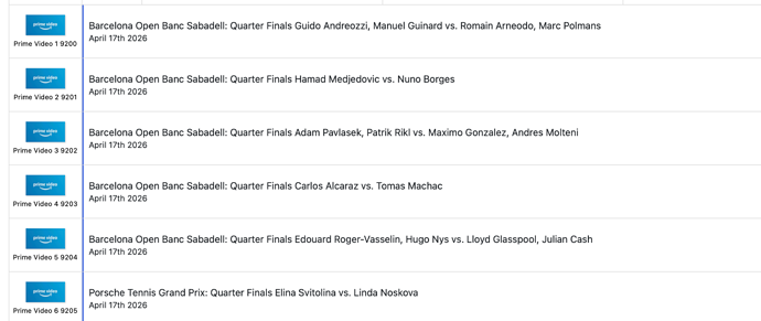

Guide looks good ok
Sample channel built by OliveTin One Click
Custom source for Prime

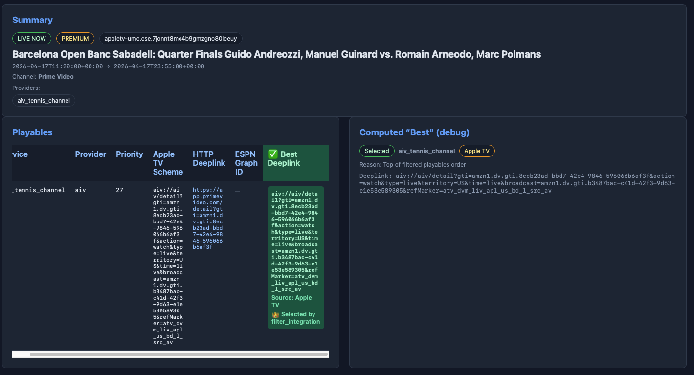

Sample event that won't open from guide. But clicking the http link works in the browser.

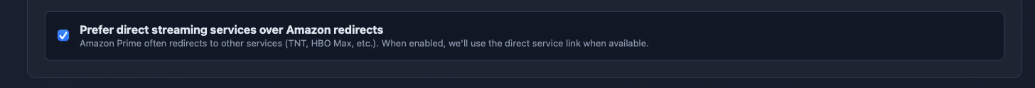

Is this option on the FDL filter page set correctly (it's set to default)? Not sure exactly what it does...
Any insight appreciated!
Paging @bnhf

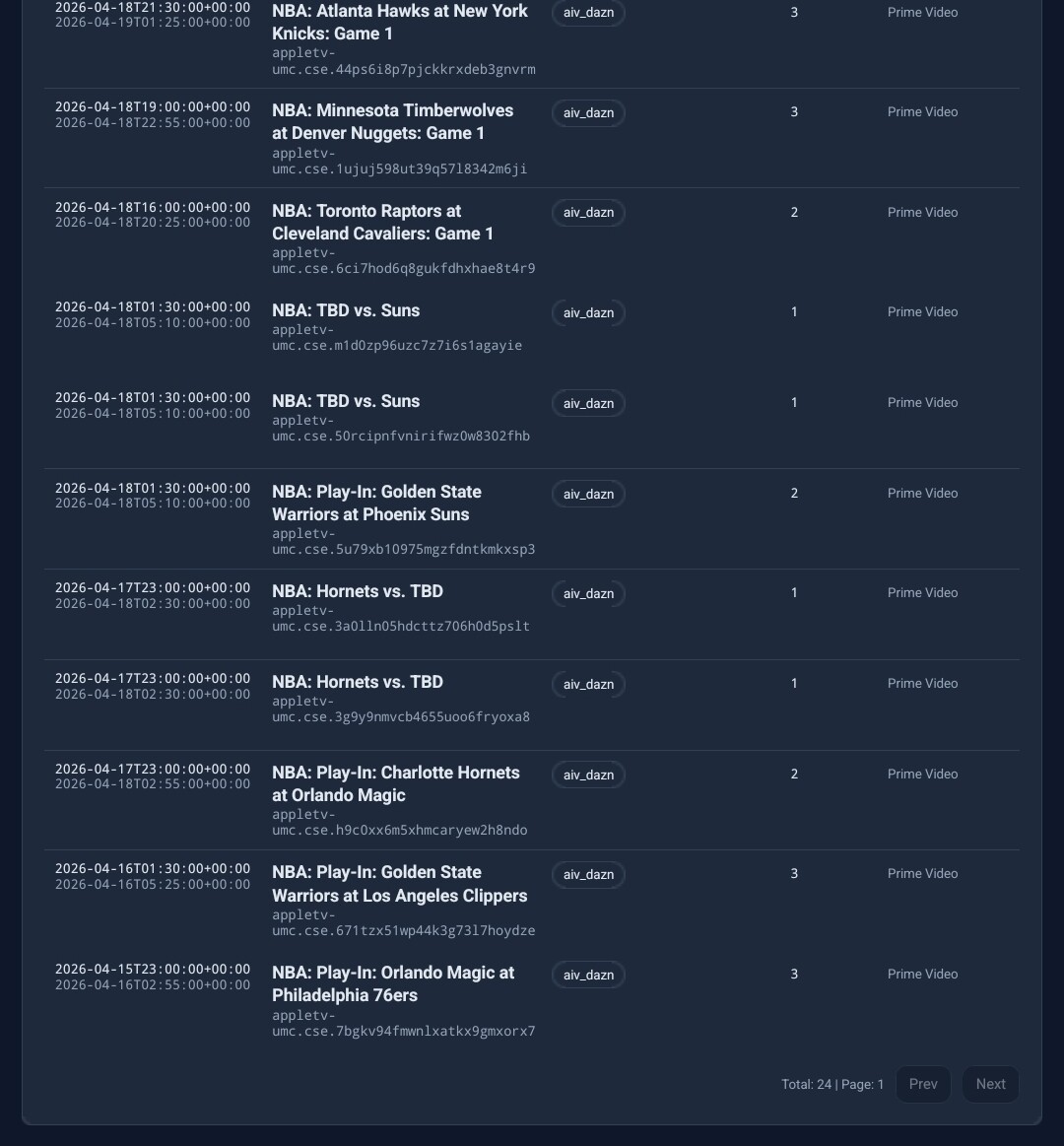

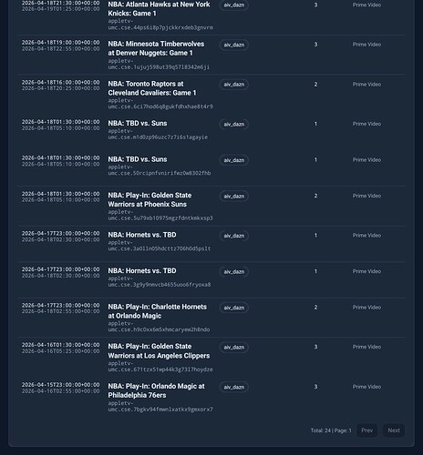

Why are NBA games shown as DAZN events when they're not?
I’ll look into it!
Th answer (supplied by @bnhf in the ADBUner thread) was to pull the development version of ADBTuner. It fixed all my tuning issues.
