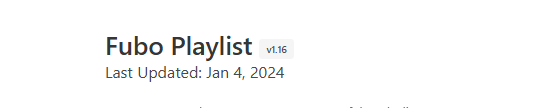

Captura de pantalla 2025-05-27 073908
is normal v1.16?
It is. That is part of the code that I did not touch. If I remember, I will update it next time I make any changes to reflect the new versioning.
Not all containers show a correct updated version number.
