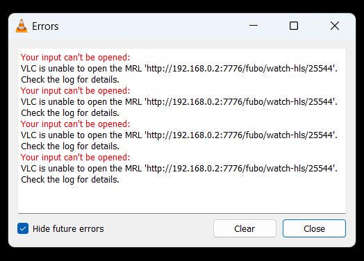

Yup, using the latest. I even pulled the indivual channel stream from the docker and tried to play in VLC, non-broadcast channels worked and CBS still seems to work, but NBC and FOX are not working.
I get this error on VLC:

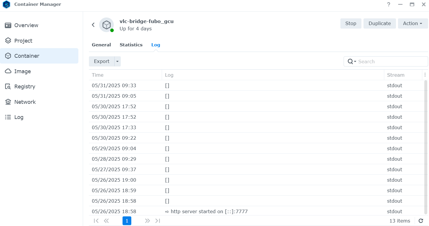

I'm in the Harrisburg, PA market. I can fire up my virtual synology server and check some other regions using a VPN when I have some spare time. I also checked the logs in the container manager, not telling me anything however.

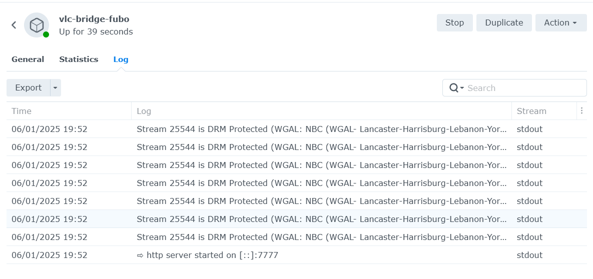

I have updated the code to now show in the portainer logs that a channel with DRM that is being tuned to has DRM. It will print this message for the offending channel.
Stream 20459 is DRM Protected (WNBC: NBC (WNBCDT – New York, NY))

Are they shown as being DRM in the container log?
