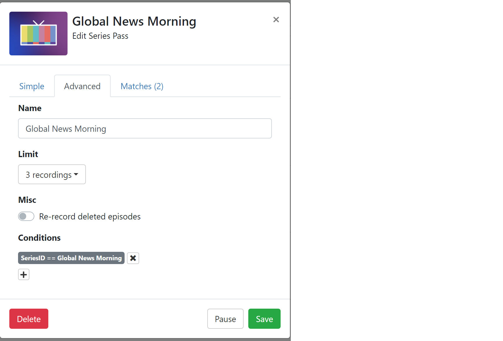

Show a screenshot of the Advanced tab on that pass.

Again, what does the advanced tab on the pass look like?

SeriesID == Global News Morning is unusual for a SeriesID
It's the XMLTV file from my IPTV provider. I just looked at the XML and there's no seriesID per se, just a title. XML for that entry appears below. Funny thing is that NextPVR works perfectly fine with the same XMLTV file.

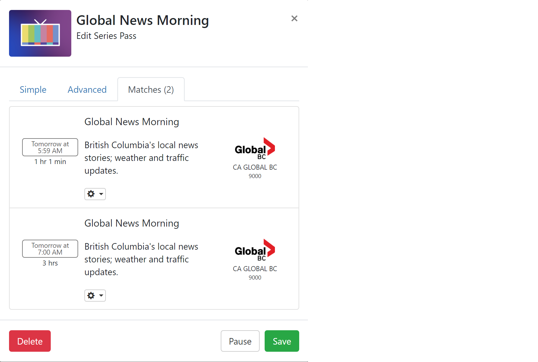

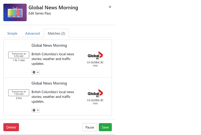

What does the pass and guide data look like for that one?

The EPG is missing a lot of information. You could try to find a different source, or remove the XMLTV and map the channels into the DVR provided guide data.
