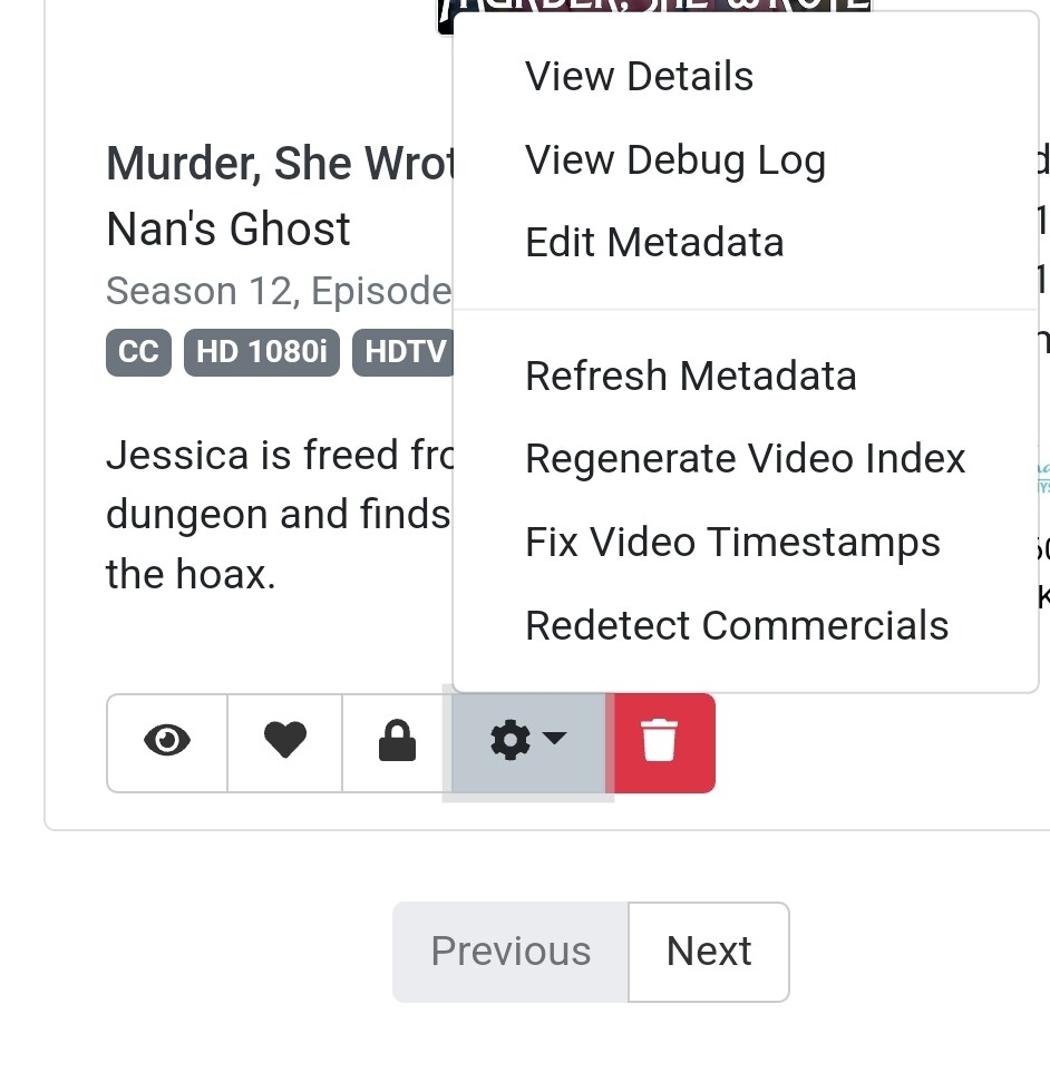

I'm not sure if that will help with your issue but maybe try "Regerate Video Index" and/or "Fix Video Timestamps" on this recording in DVR / Manage on the server.

Fix video timestamps did the trick. Thanks all!
