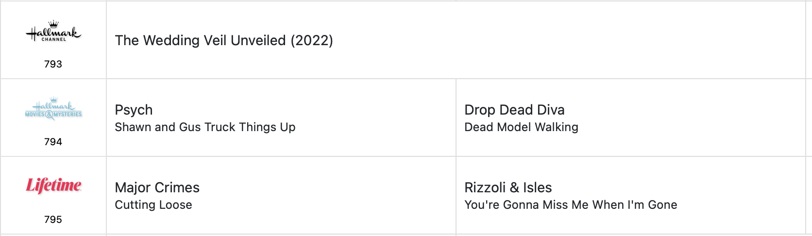

This is the lineup screenshot:
This is the Channels guide for right now:
This is the TVguide guide data for right now:
Okay it shows P versions on the right side for both, so the sync worked.
You just need to refresh the guide data now under Guide Data > Maintenance
I see Guide Data >> Redownload Guide, but nothing named "Maintenance", so I've initiated a redownload.
EDIT: That looks like it fixed it -- thanks so much! (Why was this required? The HDHomeRun already had that channel as HALLHDP, so why wasn't the initial guide download properly synched?)
