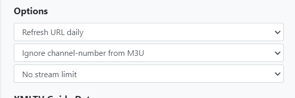

Maybe this helps not sure. But for custom channels under options you can pick Ignore channel-number from M3u.
Thanks, not sure how I missed that setting!
I'll re-add my custom channel later and try that option.
