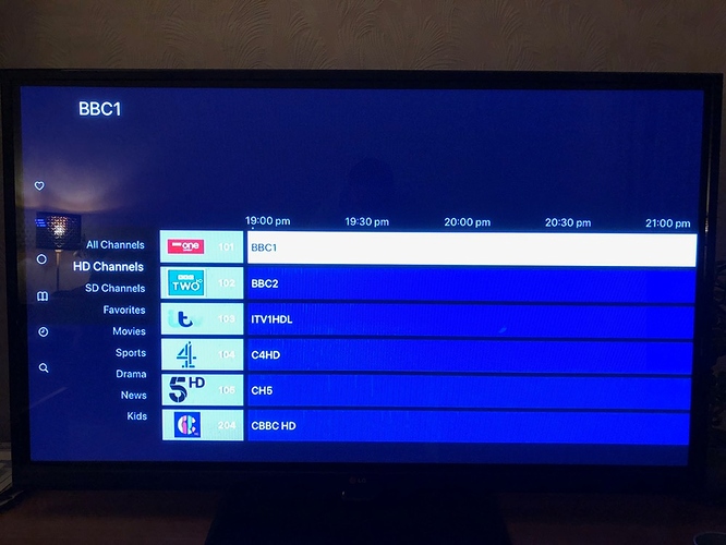

Hi, I'm getting this problem as well. Guide is fetching OK on server, no problems on iOS devices, just no guide on TVOS. I have only been using Channels for a couple of weeks or so, and it was fine until recently.
Does the DVR web UI show guide data?
Yes, the guide works everywhere except on my Apple TV. Today it works fine. I have only seen it go wrong once but my wife says it happened before (she watches TV more than I do).

I just had this problem again. Sent diagnostics from the app shortly after 17:20 (GMT). The guide does not refresh on startup. You can still watch live TV but the app doesn't know what programs are airing. The guide for later this evening is showing, but not what's on right now. If I quit the app and start again it still doesn't refresh.
