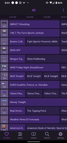

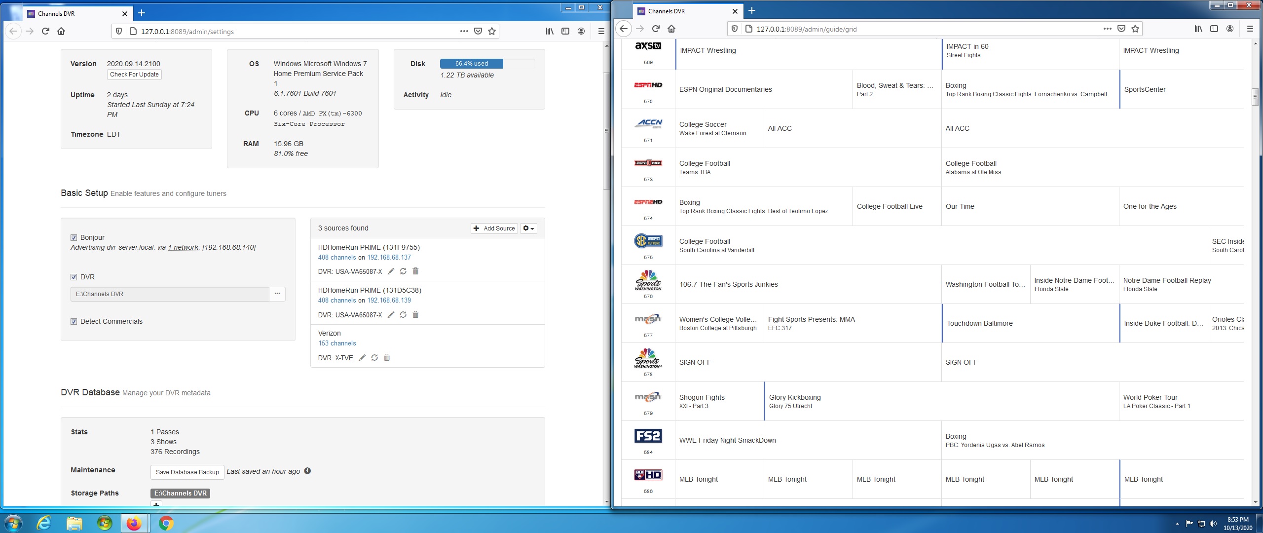

Thanks for the reply - I agree! But that's not happening. The Prime is the higher priority. When I scroll through the listing the channels are missing on any of the non DVR devices. On my computer, that hosts the DVR, the guide (through the website) shows everything....... Oddly..... the streaming version always shows up.

Also, the guide on the DVR always shows all channels; the guide on the client always tries to consolidate/merge channels from different sources if the guide data is the same.
I made sure the PRIME's are listed first and did two screen shots. The Source and guide off the DVR show all channels. The 2nd is the guide from my phone taken a minute later. I selected to show "all"... Channels 570-575 (HD channels) are missing... starting with ESPN.

You called it. Last night the PRIME's were the priority.... today they were not. I swapped the priority on the end devices and suddenly all the channels showed up.
Good call - not sure what changed from yesterday, but suddenly the PRIME's were not the priority... swapped them and the missing channels showed up. Thank you!
