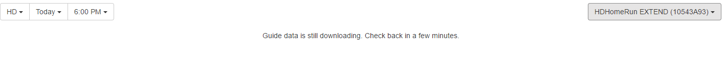

Guide not updating on latest release
What does the Log say from this morning when it downloaded guide data?
And what about the Activity section on the Settings tab?

deleted those files still the same. Missing guide data.
Wait a few minutes for guide data to redownload. You should see Log and Activity say downloading…
It has been 45 minutes
What does the log say? Did it try to download guide data?
