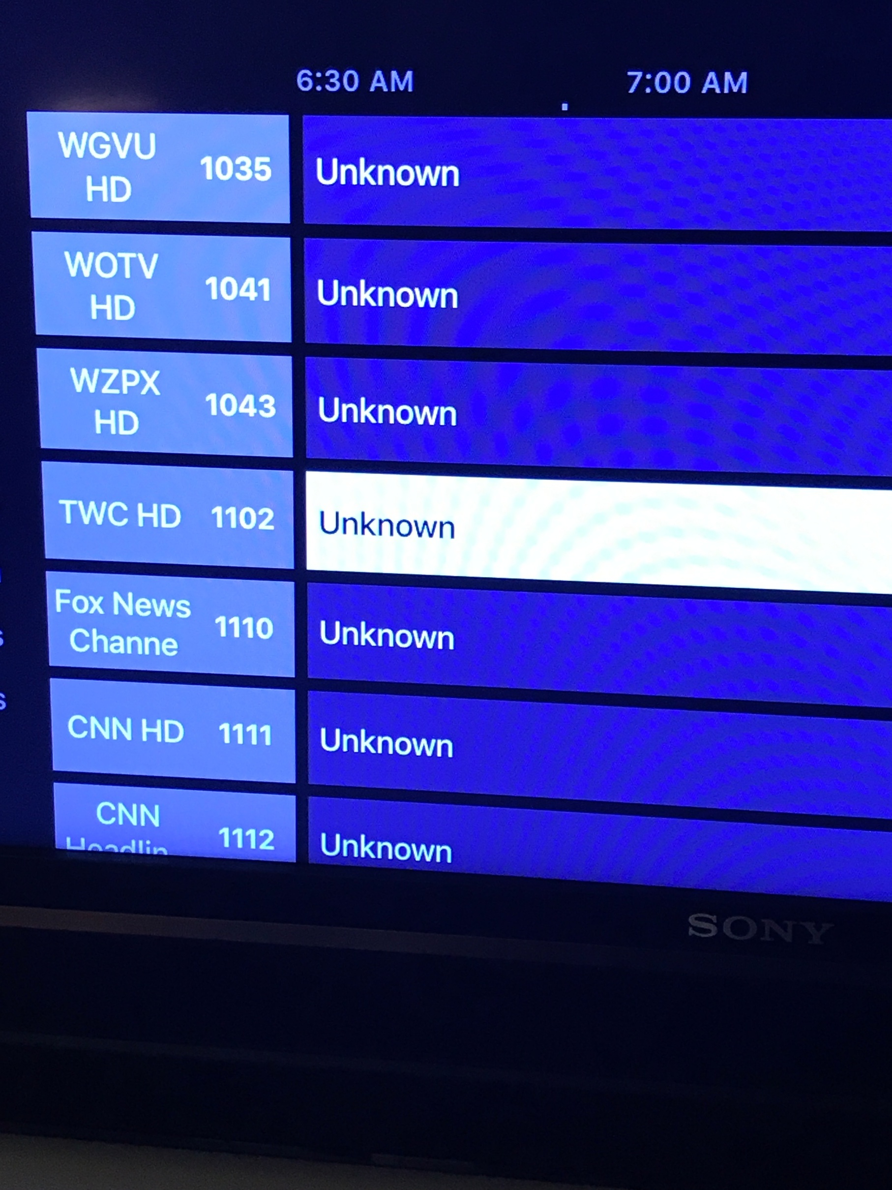

Looks like some channels are missing guide info. Will that pull in over time?
If you click the circle refresh icon it will download the missing guide data. That happens automatically every morning as well.
Lots of “unknown”, for example.
Excellent. Thanks!
Waited until this morning because I couldn’t locate the refresh button you were referencing but still no luck. See image below
On the DVR settings page, find where your HDHomeRun is shown. Under it, there is a DVR code (USA-XXXX) and next to that there are three icons. Click the circle.
Then click on the Log tab and see if any errors are being printed during the guide download process.
