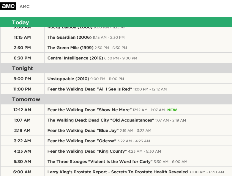

If by "Source: FuboTV", you mean a TVE source with Fubo as the Provider in Channels DVR, you can check this website for schedule times to compare.
Channels DVR uses gracenote EPG data and the same schedules are available at zap2it.com
If you put your zipcode in there and check OTA and Cable listings, they should match what you see in Channels DVR.
Of course there will be a difference in Eastern and Pacific feeds for some channels.

AMCP 6086 Guide says a show will start at 3:30 PM. zap2it says it starts at 6:30 PM
FNC 6073 Guide says a show will start at 3:00 PM. zap2it says it starts at 4:00 PM
BBCAM 6087 Guide says a show will start at 3:00 PM. zap2it says it starts at 4:00 PM
NGC 6071 Guide says a show will start at 4:00 PM. zap2it says it starts at 3:00 PM
Not for TVE channels, only for Silicon Dust HDHR tuners.
6086 is AMC east coast feed. 6:30 PM Eastern is 3:30 PM Pacific.

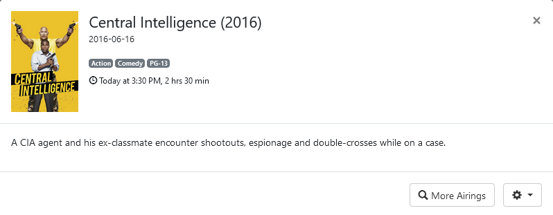

What time does your guide show this starting on AMC?
Central Intelligence (2016)
Should be 4:30 PM Mountain time
150 min Today at 3:30 PM

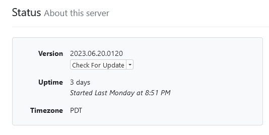

Wierd. What does the Channels DVR web UI display for Time Zone?
Screenshot 2023-06-22 at 15-04-24 Channels Settings
Shows:
2023.05.19.2045
Up to date
MDT

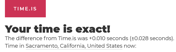

Does it say your clock is exact on https://time.is
Reports 1 min 30 seconds behind
Don't know if that small a difference would cause it.

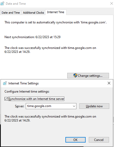

Recommend setting time.google.com as your NTP server in Windows.
