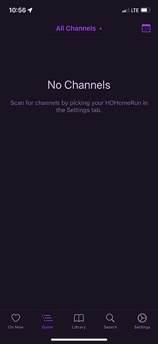

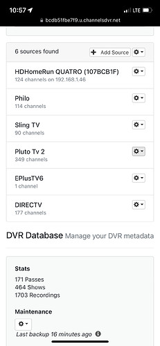

Just updated to the latest pre release. Now in the iPhone ap, I have no guide info or sources.
When I go to the online server I can see my sources there.
Any idea what’s going on?

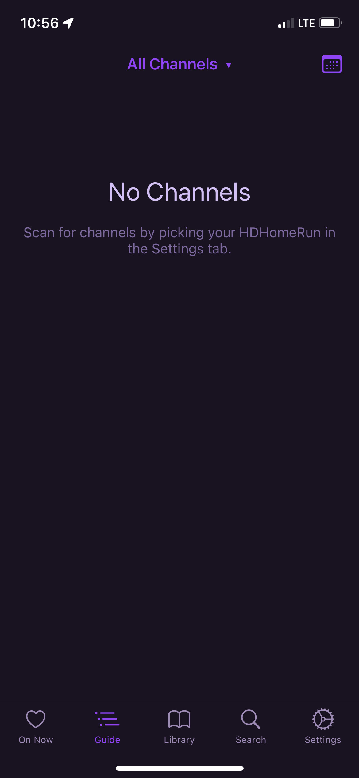

Sometimes permissions get reset for some odd reason. From the iOS home screen, try going to Settings > Privacy > Local Network and ensure that Channels has access.
Confirmed channels has access to local network (setting had not been turned off)

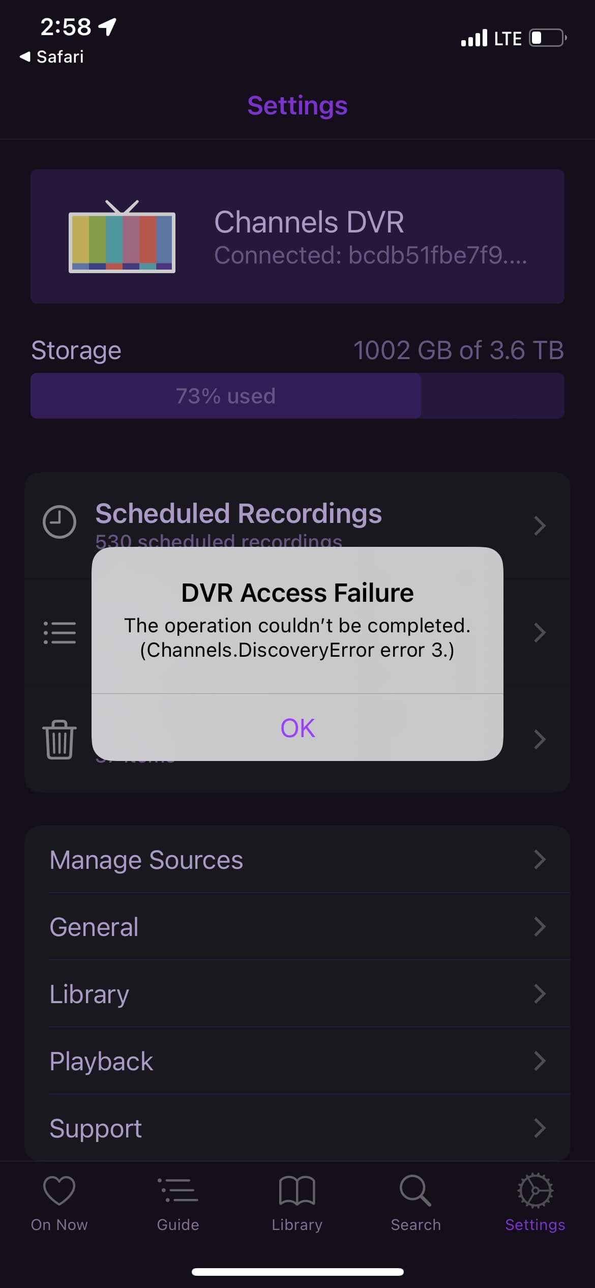

Are you having this problem remote? From your screen shots it doesn’t appear that you are on a WiFi. Remote access setup correctly?
Yes, I’m currently away from home. Had no issues until I updated the server and the iOS ap
On the app try settings then tap on the top where it says channels dvr and logout relaunch as away from home. If that doesn’t work submit diagnostics

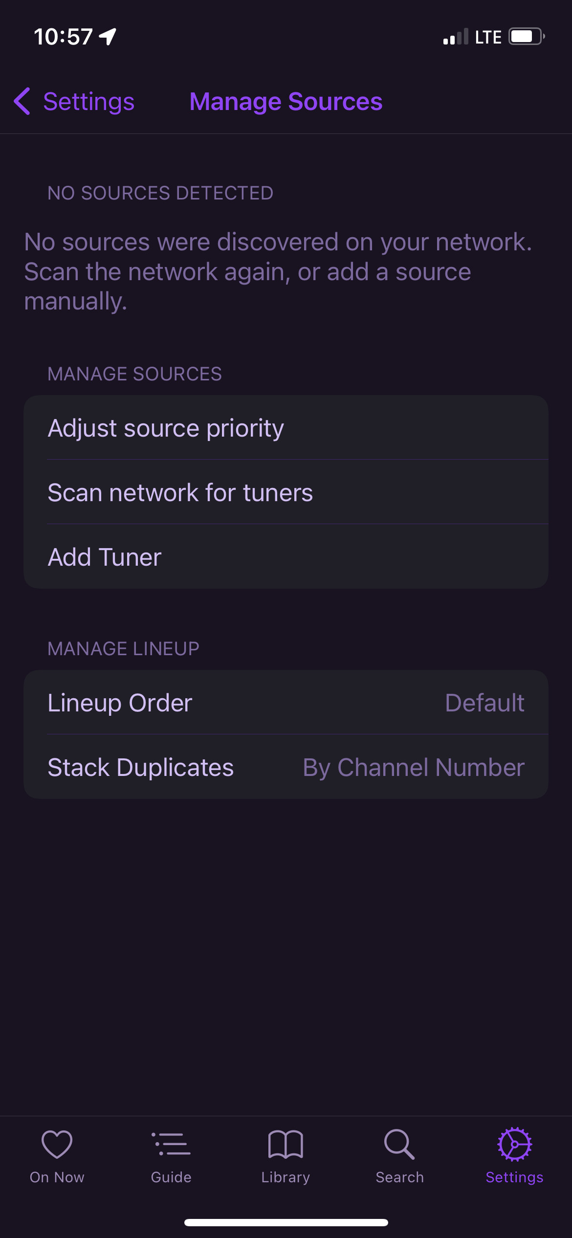

At home, accessing on home network. Can see guide data, but only for my HD Homerun Channels. Nothing for the TVE sources. I can see all of my channels on the Tivo Stream ap.
Also missing all sources except my hd homerun on my Apple TV

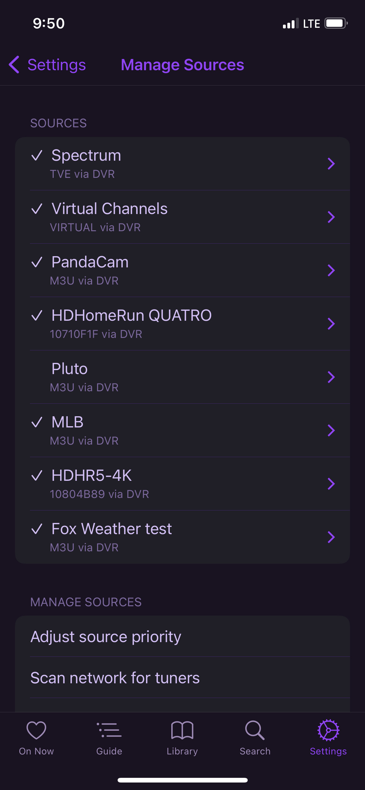

While on your home network and in the app, are there check marks beside the sources under settings like pic below? Have you tried restarting the server? Check for forced settings to client from server side. Are you using a Mac for your server? That prerelease had to do with Mac bugs. Maybe it broke more than it fixed
No. My TVE sources didn’t appear at all.
Just saw another pre release and undated. Now all of my sources are showing again in the ap.
