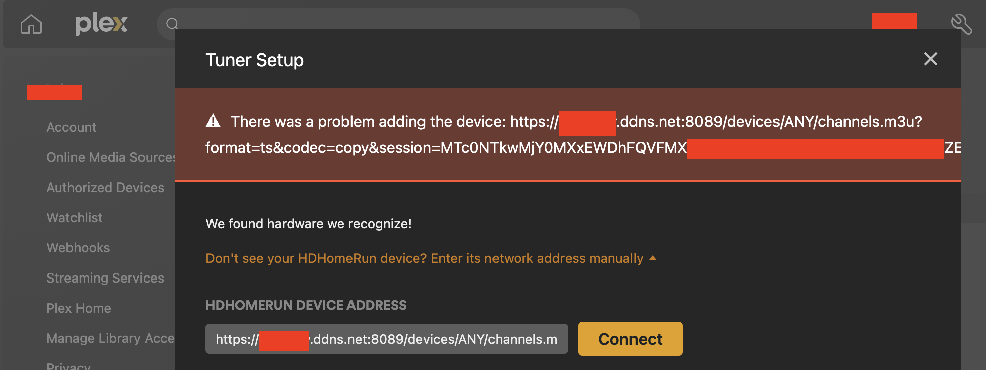

Edit: Update: I attempted this several times and acquired several different session cookies with different browsers. Still get the error that there's a problem adding the device...
PS: The screenshot shows hardware recognized, but that is my ThreadFin server, not Channels.
You are not using the correct URL. You are using a ddns.net address. You need to use your unique channels alphanumeric url it forwards you to when you login to my.channelsdvr.net you also need to loose the format=ts. Change only the fxxxxx to yours and leave the rest alone.
The chrome cookie has always ended in ==
You are not trying to host your channels server in a cloud are you?
I have my own ddns.net dynamicdns tied into my router and 8089 port forwarded. It works well with my ThreadFin setup. But not with Channels; even when switching back to the channelsdvr.net URL, it still doesn't work in Plex. I am, however able to open a web browser while connected to my personal hotpsot and download the m3u file by pasting that address even though I have yet to authorize on this network and incognito window.
This will not work with channels and session id cookies. What is the exact channels url you are trying? Change your alphanumeric and shorten the cookie to 5 characters for privacy.
In cdvr settings remote needs to be enabled and 8089 forwarded. Can you reach your dvr from your phone app while on cellular data?

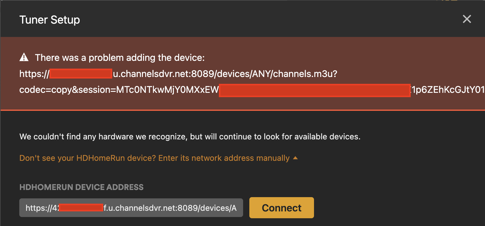

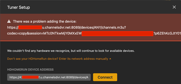

Did you see my last screenshot? I switched it to 4___f.u.channelsdvr.net (the URL directly copied from Sources > Copy M3U URL. and then added &session= with my cookie and removed format=ts. Still not working.
Yes. Remote is enabled, 8089 is forwarded and I can reach the DVR externally.
Edit: My full URL looks like this:
https://4REDACTED3f.u.channelsdvr.net:8089/devices/ANY/channels.m3u?codec=copy&session=MTc0NREDACTED
Sorry your screenshot wasn’t up yet when I started to respond. Your URL looks good. If you follow the steps in post #1 with guide data and it still doesn’t work I guess session id won’t work with plex tuner.
https://xxx.u.channelsdvr.net:8089/devices/ANY/guide/xmltv?duration=604800&session=xxx
Session id works with dvr to another dvr so I figured it was possible with plex. It’s possible cdvr doesn’t have code built in to handle session id and plex as noted there is some background things going on.

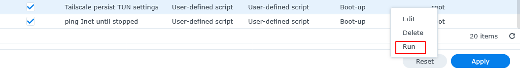

Curious if anyone has has been succesful in using CDVR as a tuner for Plex accross Tailscale? I have a Synology at my mom's cabin in the mountains and I was trying to share the M3U from it to my local version of Plex at my house. I haven't been able to get the CDVR to be seen across Tailscale, even when adding the IP address manually (Plex does see my local server).
I've also tried using Threadfin at the cabing to supply the Channels M3U to m local Plex and I can get Plex to see that and download the guide and populate the grid, but when I click on any channel, it never plays except when I manually play the channel using the specific channel M3U on VLC, then that channel will play on Plex.
Checkout this Tailscale article https://tailscale.com/kb/1131/synology#enable-outbound-connections
Thanks. I don't recall when I installed that script but I have it running on both of my Synology NAS boxes (both the local and remote).
I'm assuming that it's letting the traffic through as I can see the channel load in the originating CDVR server, but it only shows the connection for 5 seconds and then drops. And if I manually watch the channel through VLC and have an active stream going, then I can trigger through the CDVR->Threadfin->Tailscale->Plex connection and it will play, but id the VLC instance isn't working, then the Plex player won't initiate the channel.
I've checked CDVR and Threadfin logs, nothing useful is showing as far as I can tell. Will keep researching, but this is well above my technical knowledge, so not sure what else it may be.
Jay
You have to run the script manually after every Tailscale package update, since the Synology Task Scheduler only runs it at Synology bootup. Yes, a pita.
Upgrading the Tailscale package will require the above script to run again. When you upgrade Tailscale, run the above script as root, or reboot your Synology device.
That did the trick, thanks. Never would have figured that out myself.
