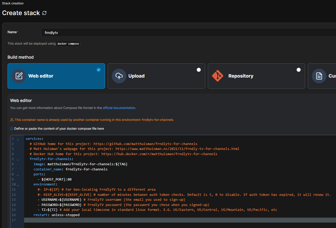

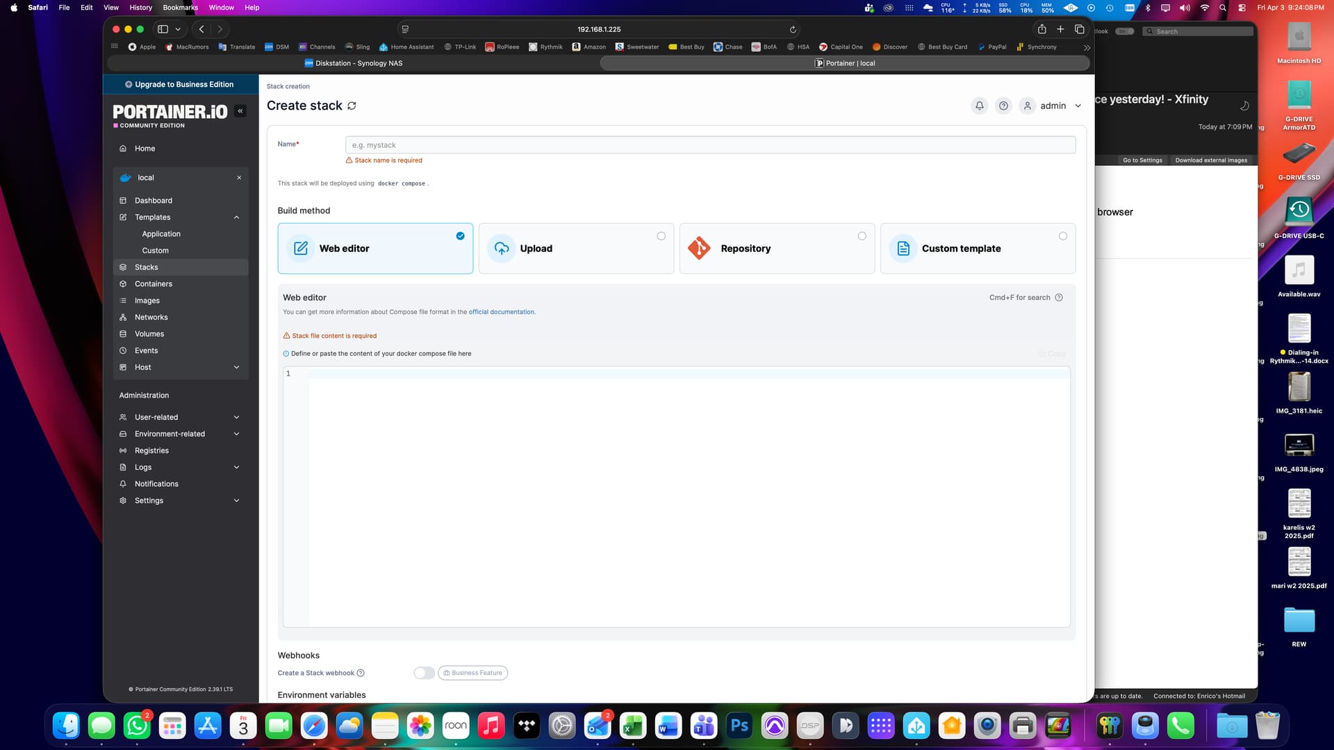

I think the problem is that I haven't created the Stack LOL and for that I need help LOL

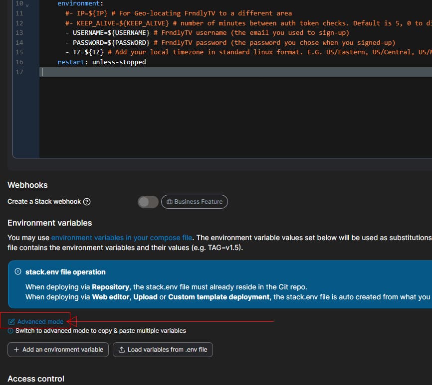

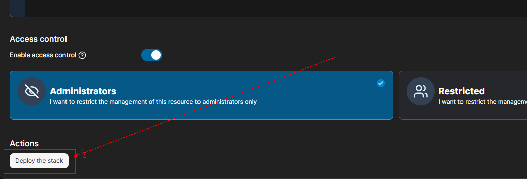

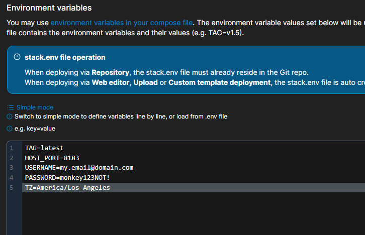

Since you skipped a step and already created the container without using a stack compose, you will have to stop and delete the existing container you created before deploying this stack.
You my friend are THE BOMB!! It is working :slight_smile: And Hallmark channels are working too :slight_smile:

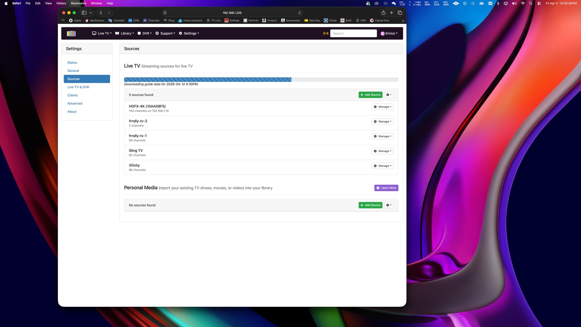

With your help, I was able to get Hallmark channels working with Channels DVR using Frndly TV as the TV provider. I cancelled Xfinity NOW the same day I got Frndly TV working. Thanks again for your help!
