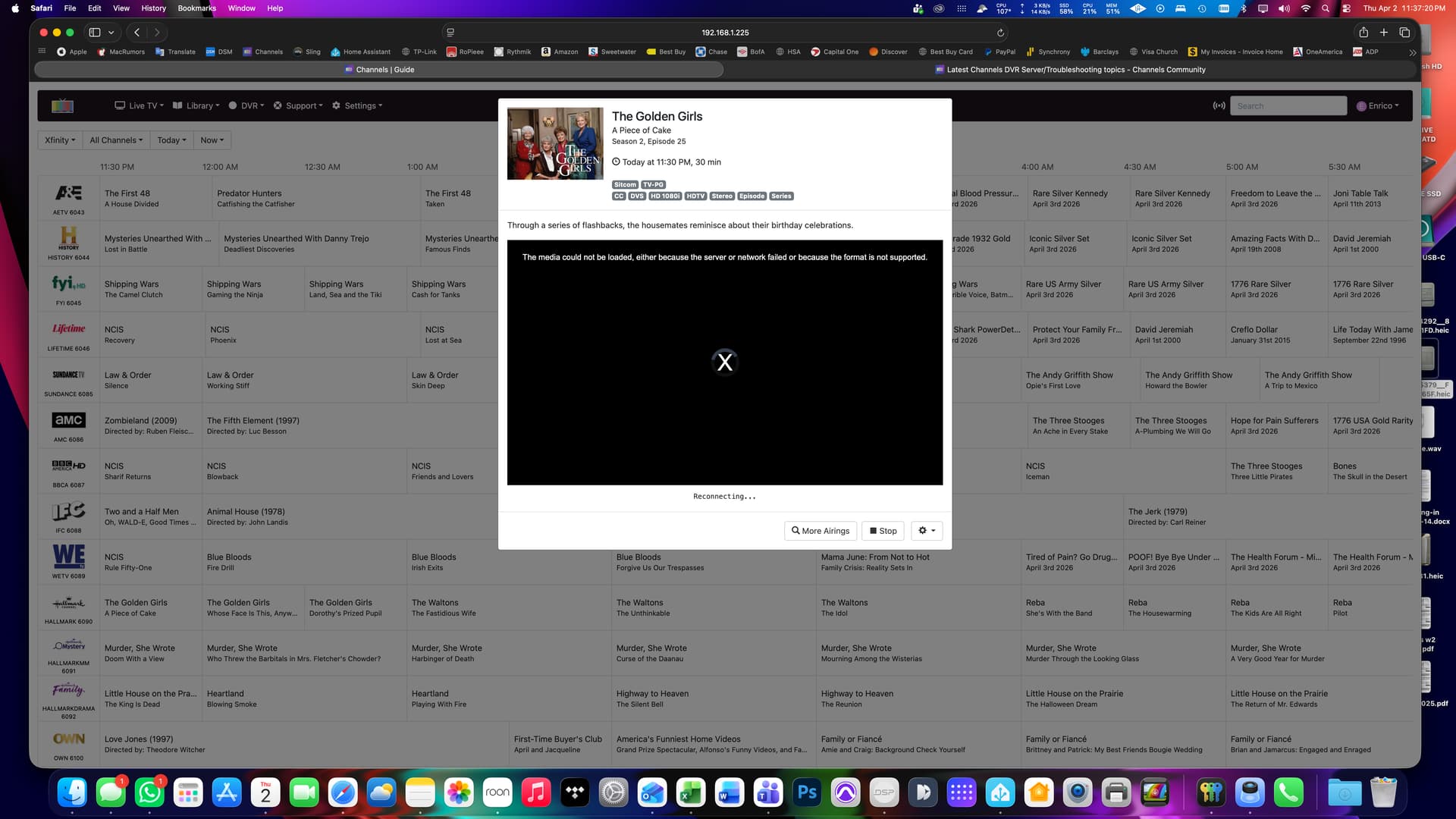

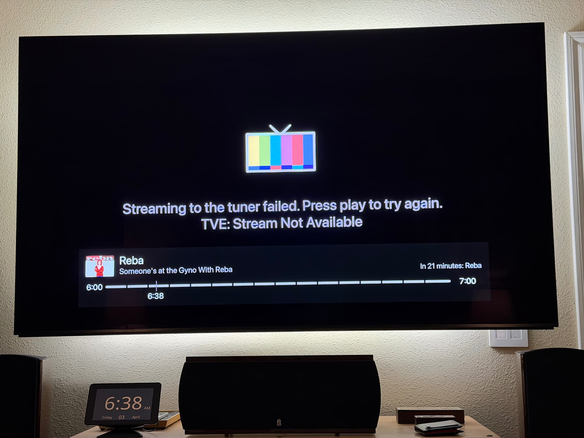

Since yesterday, Hallmark channel stoped broadcasting over Channels DVR. Its works perfectly fine using Xfinity Stream app. On wed browser shows: "The media could not be loaded, either because the server or network failed or because the format is not supported" and over Channels DVR on Apple TV shows: "Streaming to the tuner failed. Press play to try again. TVE: Stream not available". I tried deleting and adding the Source again with no avail. All other channels from Xfinity work fine with Channels DVR but the three Hallmark channels. It has been working for the last 2 years and yesterday stopped working. Nothing has changed in my system, nor in my Xfinity account. Any help would be appreciated.
I’m guessing this explains why access got blocked. I can definitely confirm that Halmark channels are not available over TVE through Channels DVR + Xfinity TV as TVE source. I hope Channels app DV Team finds a workaround for this….

Pretty sure they just discontinued supporting that TVE access where you authenticate with your provider credentials at their live website.
If you can't link your Provider at their live website and stream it in your browser, it's not going to work in Channels DVR. And even if you could, if the stream has DRM it's not going to work in Channels DVR.
I tried Frndly TV and Hallmark channels are not working as well. Looks like Hallmark disabled TVE capabilities.

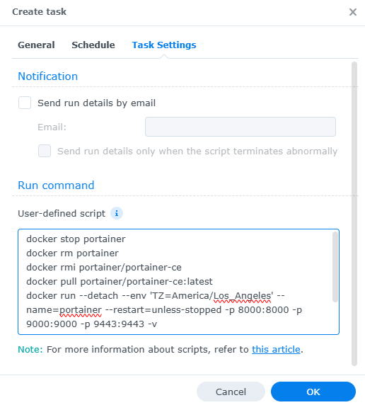

Setup a task to Install and Update portainer ce

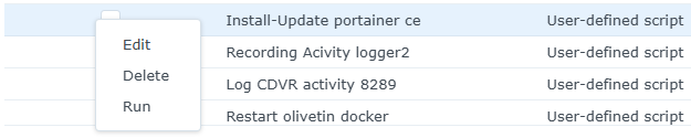

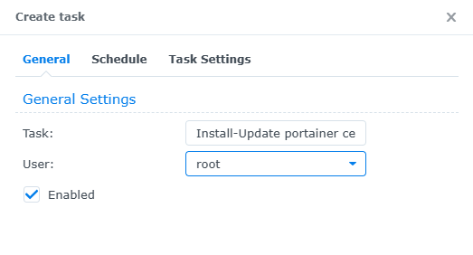

Synology Control Panel > Task Manager > Create > Scheduled Task > User-defined script
Be sure to select user root
brave_screenshot

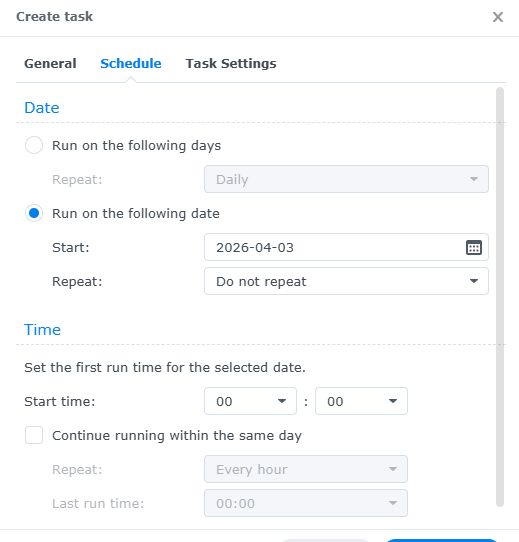

Schedule to run once in the past as you'll run this task manually
Paste these lines in as the Run command User-defined script (adjust for your TZ Time Zone)
docker stop portainer
docker rm portainer
docker rmi portainer/portainer-ce
docker pull portainer/portainer-ce:latest
docker run --detach --env 'TZ=America/Los_Angeles' --name=portainer --restart=unless-stopped -p 8000:8000 -p 9000:9000 -p 9443:9443 -v /var/run/docker.sock:/var/run/docker.sock -v /volume1/docker/portainer:/data portainer/portainer-ce:latest
Then click OK to save the task

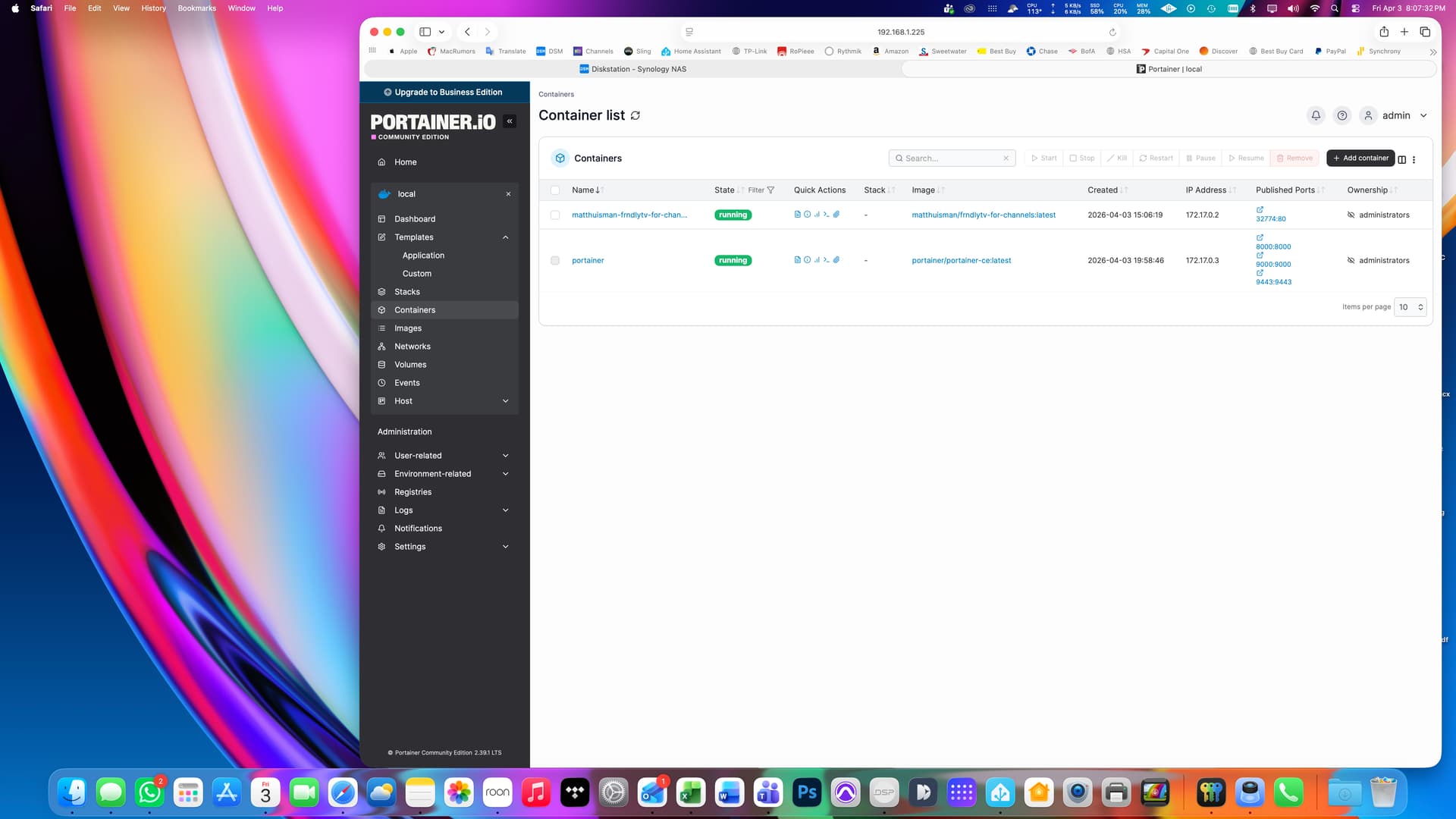

Select the task from the list and Run it
brave_screenshot (3)
Repeat doing the Run whenever you want to update portainer ce

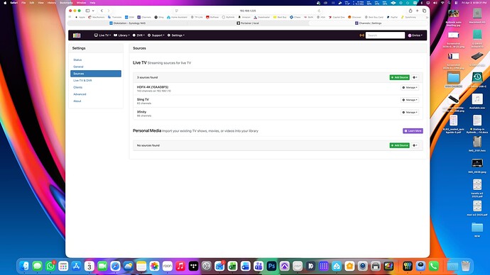

I'm running portainer already. What would be the next steep to get Frndly TV working with Channels DVR?
Create a new stack using FrndlyTV-for-Channels
Oh, I see you already have the docker container running

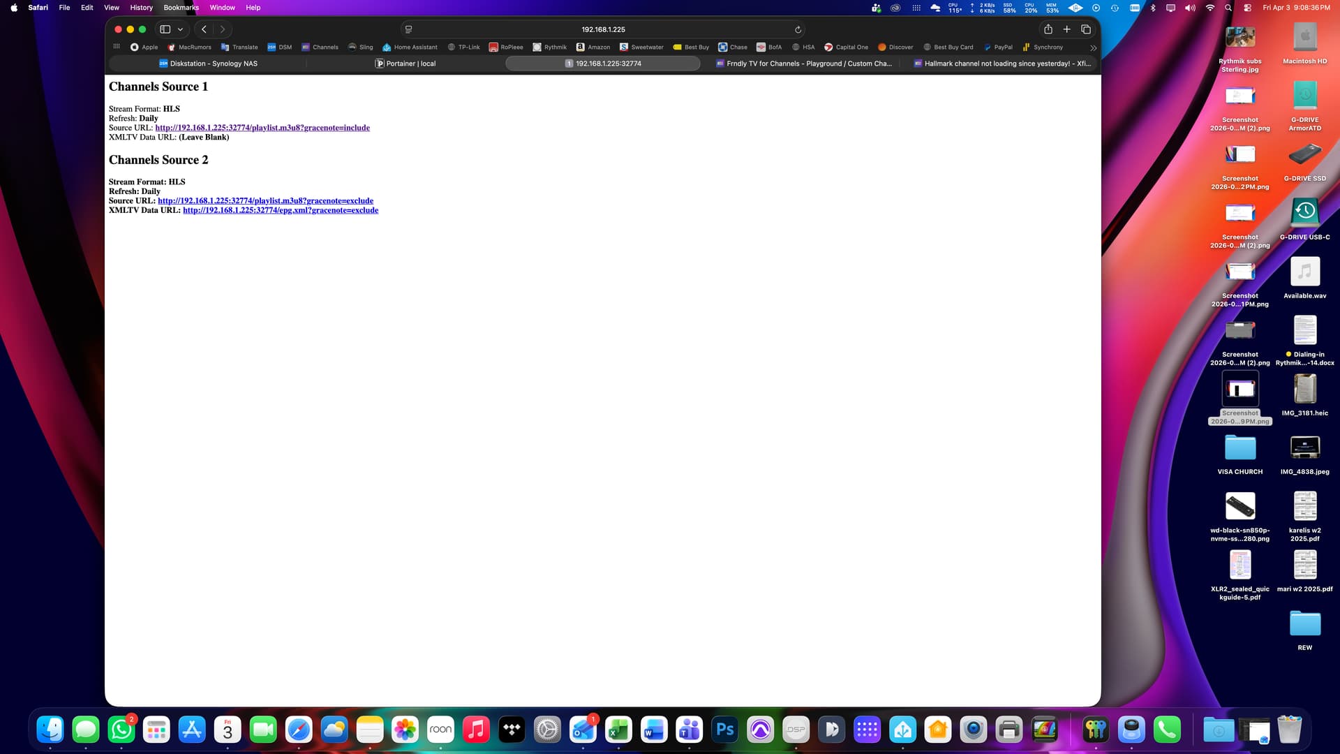

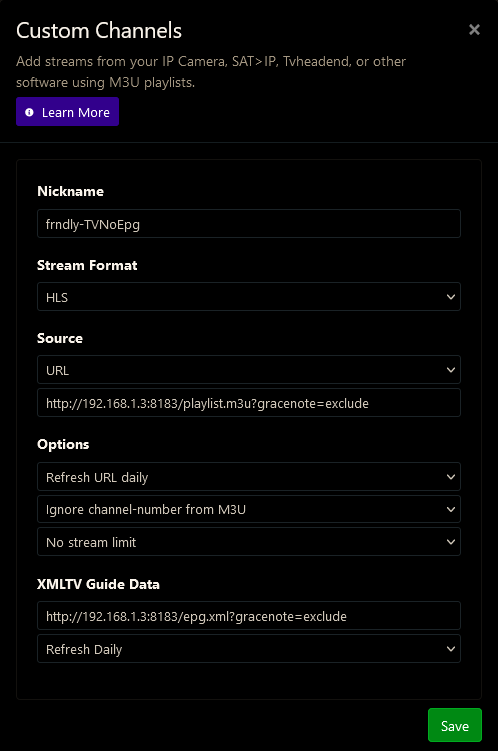

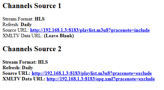

Bring up the web page for the docker container (From your screenshot I'm guessing it's at http://192.168.1.225:32774) and use the values shown
brave_screenshot
to put into two new Custom Channels sources.

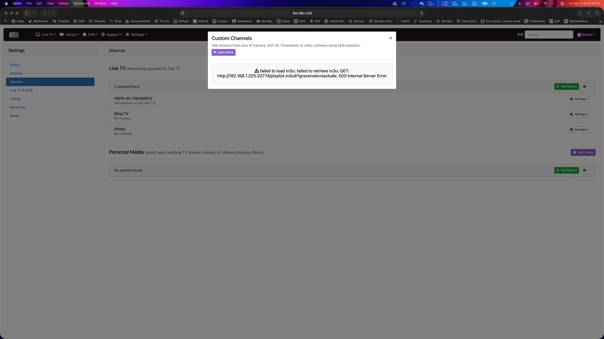

I'm getting Failed to load m3u message. I think it is something wrong with Frndly-tv docker container.
What does the portainer stack and environment variables you used look like?

Maybe it's your username or password.
Look at the Frndly container log in Portainer
