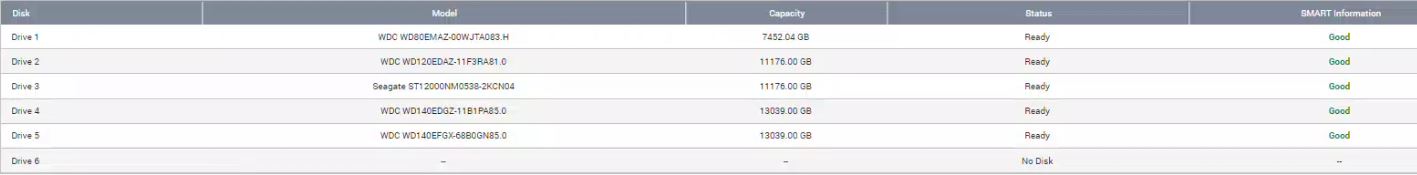

That transfer speed is about what I'd expect from 100-Mb connections. Are the NAS connections at 1-Gb as you are expecting? More than 1 stream could be a problem. Can you see the health of your hard drives in your NAS?
I can see the health of the drives and they are all good. It also looks like my bonded Ethernet ports are connected at 1gbps...
I guess I will have to do some more troubleshooting.
How are the read speeds from you NAS?
Around 500 Mbps. Something doesn't seem right.
