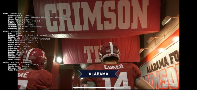

Here’s what I’m seeing. Is it supposed to be HEVC under video format?
I’m remote streaming.
I may have figured it out. I had it set to original not 8mbps.
