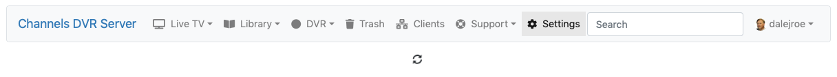

I am having trouble setting up remote streaming with my AT&T Fiber. As best as I can tell, I have forwarded port 8089 TCP and UDP to the Mac mini that hosts my channels.
When I test it by going to my.channelsdvr.net, the page begins to load, but then a spinning wheel shows up right under the headers and never goes away. Here's a screen grab:
Any ideas what I might be doing wrong or things to check? Thank you!
What browser are you using? Maybe try a different one.
Thank you. I have the same behavior on MacOS Safari and Firefox, and Windows 10 Chrome. On all browsers and platforms I am sent to the DVR page, but nothing loads beyond the headers. I have this same issue on the Mac mini hat I have my DVR set up on and also a remote laptop.

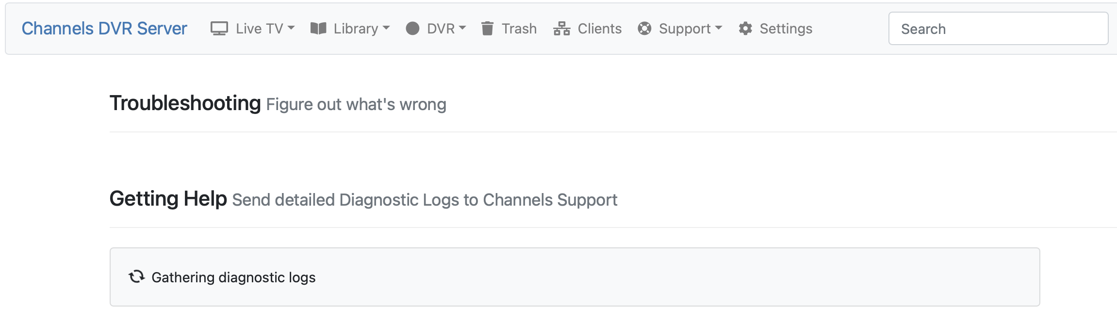

Please click Support > Troubleshooting > Submit Diagnostics
Does that troubleshooting page load?
Can you check the browser js console to see if any errors are shown there.
It just spins and spins on "Gathering Diagnostics Logs"
