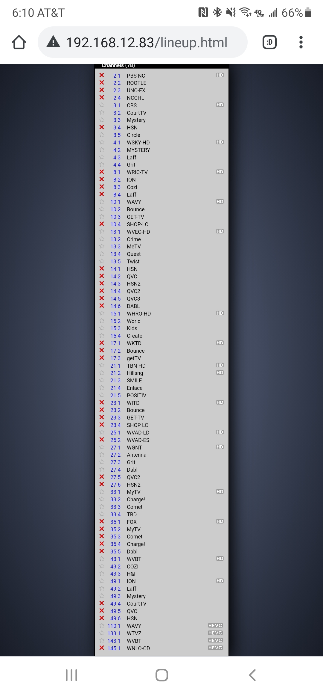

There isn't a concept of autofailover. Your HDHR will put a 1 in front of the channel that is ATSC 3. (see my pic)
This way you can tune either signal. So if you create a season pass for a show and designate the ATSC 3 channel it will not fall back to 1.0 if there is a conflict.
