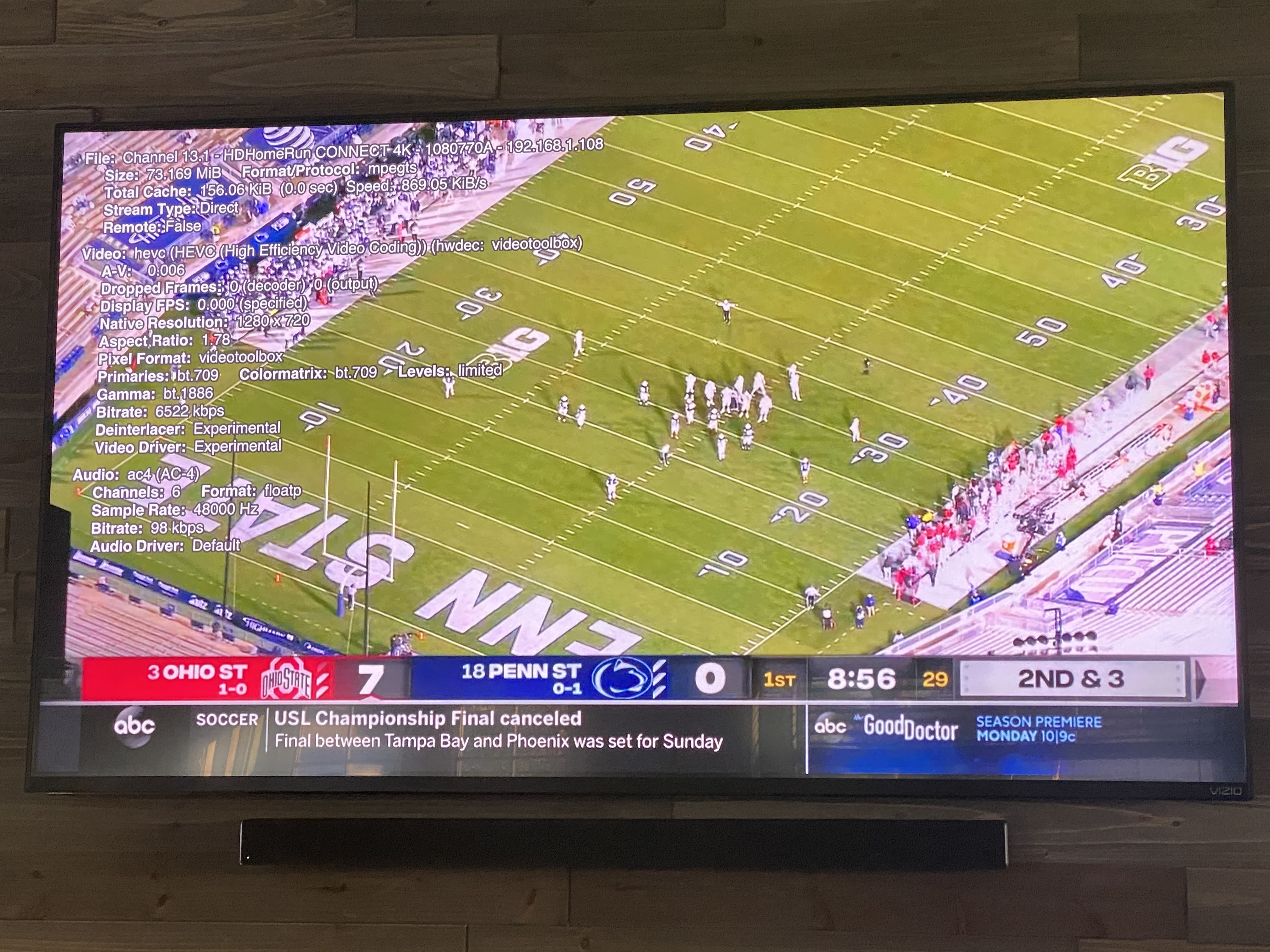

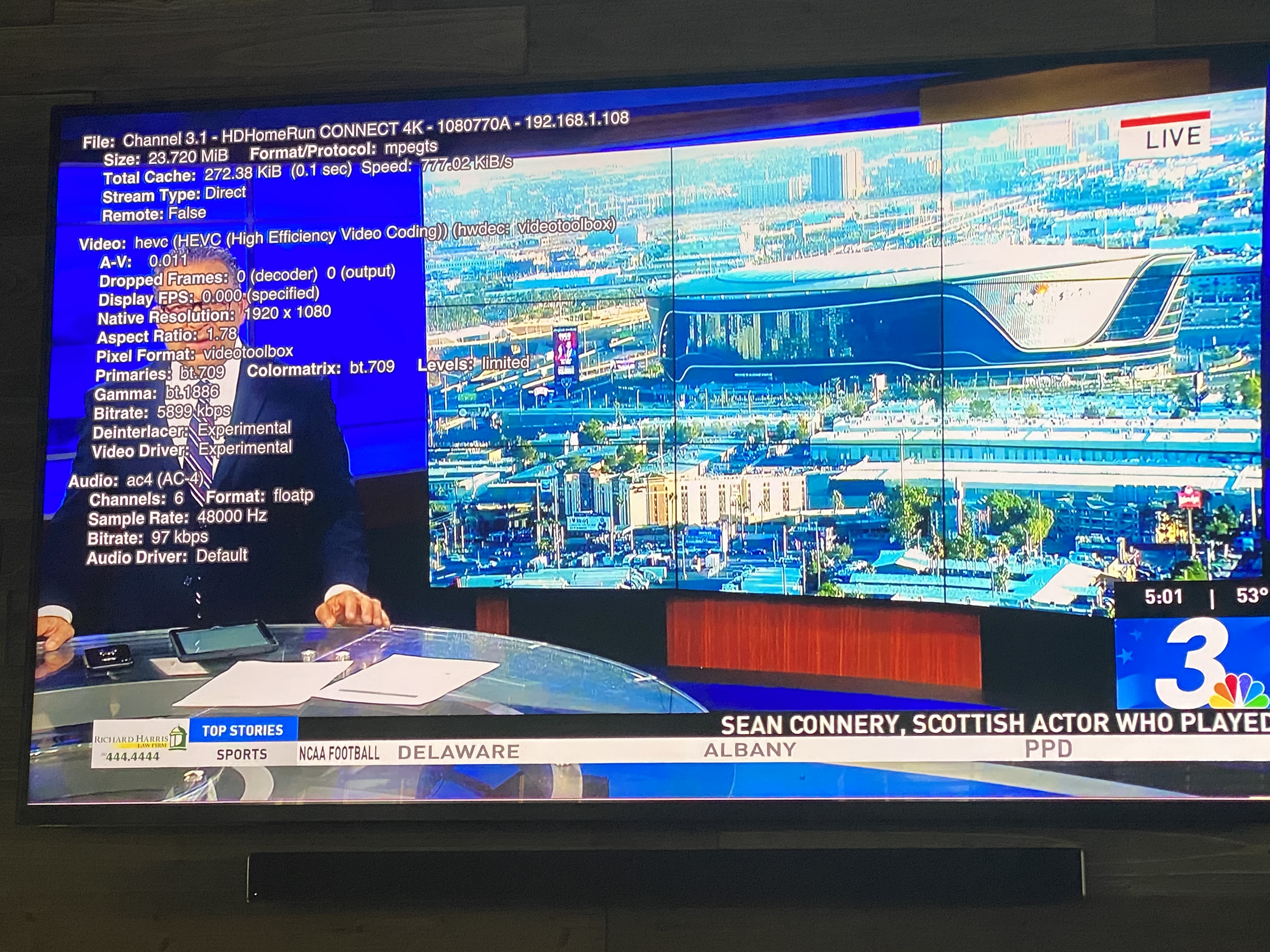

Interesting. I added the HDHR 4k tuner to my Emby setup. The ATSC 3.0 channels play audio and video without the pauses watching live tv. Running the latest HDHR firmware.

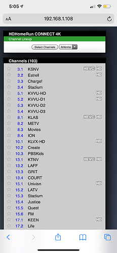

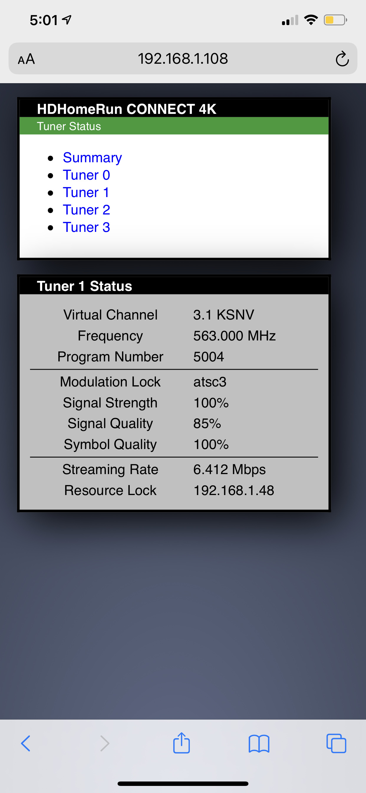

BTW did you look at the HDHomeRun config to make sure you were watching ATSC 3.0 in Emby???
Yes. Confirmed ATSC 3.0. However, FOX and ABC are now not playing on anything. I get a no video error. CBS and CW are still okay with Emby. NBC now rolls over to ATSC 1.0. I guess they are doing something in my market today.

HDHR 4k firmware 20201030 seems to have fixed the majority of issues with audio and video.
CBS, NBC and CW play without any issues. ABC plays commercials fine, but when playing a show the sound is garbled. Fox is sill HD only and has been non-ATSC 3.0 for more than 5 days.

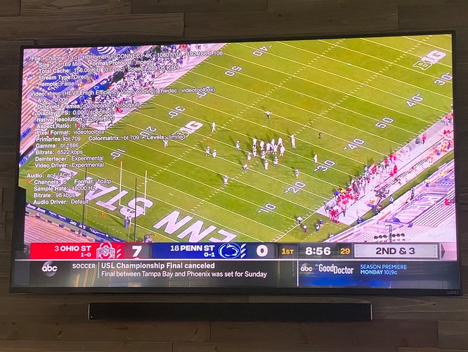

Thanks for posting pics. How was the quality on the Ohio State game compared to ATSC 1?
No difference. Still HD
