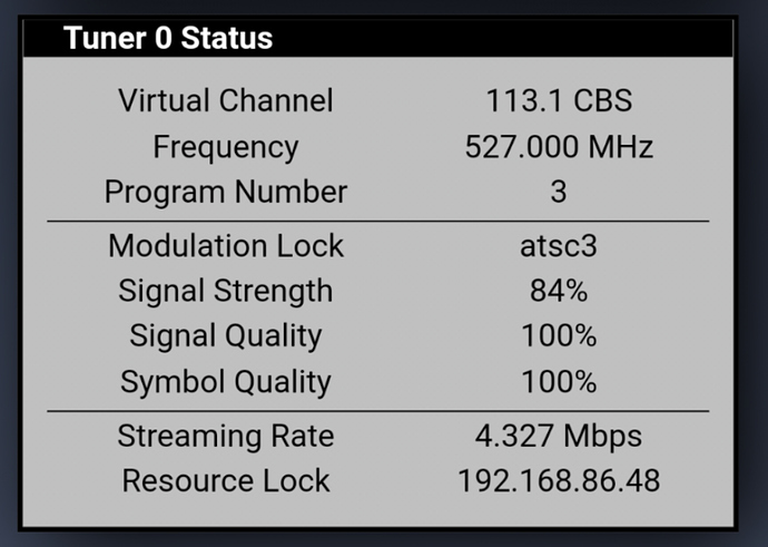

I noticed that when someone is watching one of the ATSC 3.0 channels that the admin page doesn’t show the rate that is being transferred. Do I need to submit diagnostics for this?
Known issue. It is not being reported by the tuner.
Do I need to report this on the silicondust forum?
Does it show network bitrate on the tuner status page on the hdhr?
