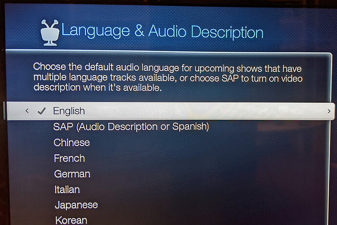

Yes I understood that well enough, but thanks for the additional detail. However, TiVo (in TE3 at least) lumps Spanish and Audio Description together under SAP. Might that also be the case for Channels DVR as well?
I don't know. I have the same settings you show on my two TiVo's.

As a test, I used Channels DVR to record an episode of Friends on TBS from my HDHR Prime tuner source since the guide data had the DVS tag.
It does have DVS / Audio Description when selecting the SAP audio track for playback.
I wouldn't have guessed that since it labels the SAP track as Spanish.
