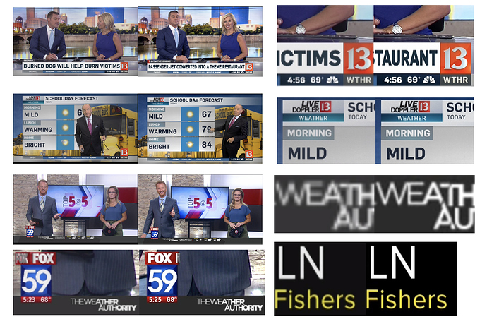

HDHomeRun's output of live and DVR was definitely a 30p look, which made 1080i stuff have jagged edge graphics and a very obvious de-interlaced 30p look (I work for a TV station and have worked in the video world for the past 27 years, currently doing most stuff in 4K 60p) so that was an additional thing I sought out more information about. I tried out Channels on my iPhone and instantly enjoyed the GUI much more, but then when I started watching live TV, I then noticed just how bad the HDHomeRun output was in comparison. Channels is outputting a 60p signal that preserves the smoothness of a live 1080i or 720p broadcast, but then also keeps the graphics smooth and clean. Here are some additional findings when I inspected frames in detail, along with the attached image which shows HDHomeRun on the left, and Channels on the right in each scenario. The channel 13 examples are 1080i, the channel 59 example is 720 60p:
HDHomeRun has 29 pixels of black at the bottom, 0 at the top, 1 pixel on each side
It’s scaled up to 100.3% compared to full size 1920x1080, which also results in a few rows of cropping at the top and bottom
Channels
1-2 pixels of black at the top, 0 at the bottom or sides
Black levels (bottom right corner of sample pic) the Channels App had a Hue, Saturation and Black level of 0, 0, 0 where the HDHomeRun had 293˚ Hue, 11% Saturation and 7% Black levels. Definitely washed out, and also the whites on Channels measuring 99%, the HDHomeRun whites only measure 92%, resulting in the very flat picture.
I was told by HDHR that the Fire TV Stick 4Ks were switched to software decoding of MPEG2 because the hardware decoder was broken from release and Amazon just released the fix a couple weeks ago. They are now going to send an update to switch the Fire Stick 4Ks back to hardware decoding. Obviously that likely won't help with decoding on iOS (unless they switched it for both) and also it doesn't improve their GUI for live TV grids or DVR listings and functions. So I still may eventually move to Channels and just not use the DVR function of the Scribe in that case.

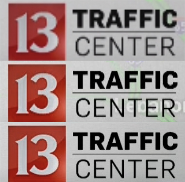

Just for kicks I used VLC to open the HDHomeRun tuner on the local network, chose a channel, and the image quality from that on iOS and FireTV is the best of any. Top HDHR, middle Channels, bottom VLCHDHRchanVLC
VLC has many options for deinterlacing. Which one was selected?
On the FireTV is Decoder set to Hardware or Software in the app?
That's where it gets interesting. The graphics above were from a 1080i news broadcast, and were taken from an iPhone. The settings for VLC in that were Deblocking: Medium, Deinterlace: Off and Hardware Decoding: ON
On one of my 4K FireTVs (pendant) the VLC and Channels looked identical. VLC had hardware decoding off (which that shouldn't have hardware decoding anyhow I think?) and deinterlace was on auto.
On a 4K Fire Stick, VLC was a little noticeably better than Channels, similar to the iOS example in my pic. I will have to check tonight, but I'm pretty sure I looked and hardware decoding was also off, and deinteralce was on auto.
