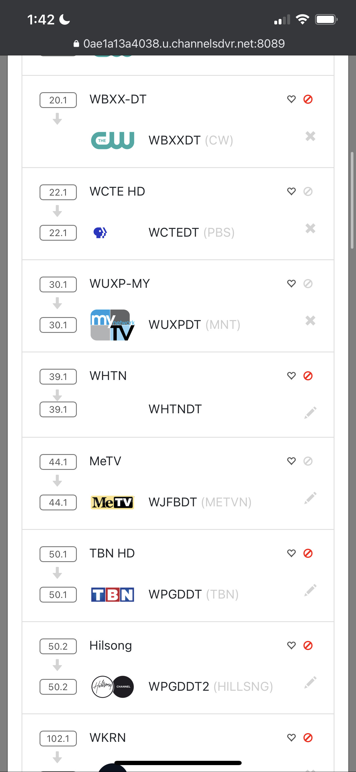

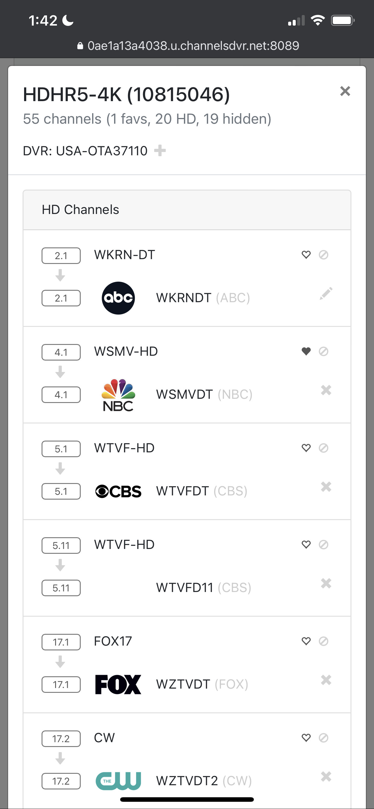

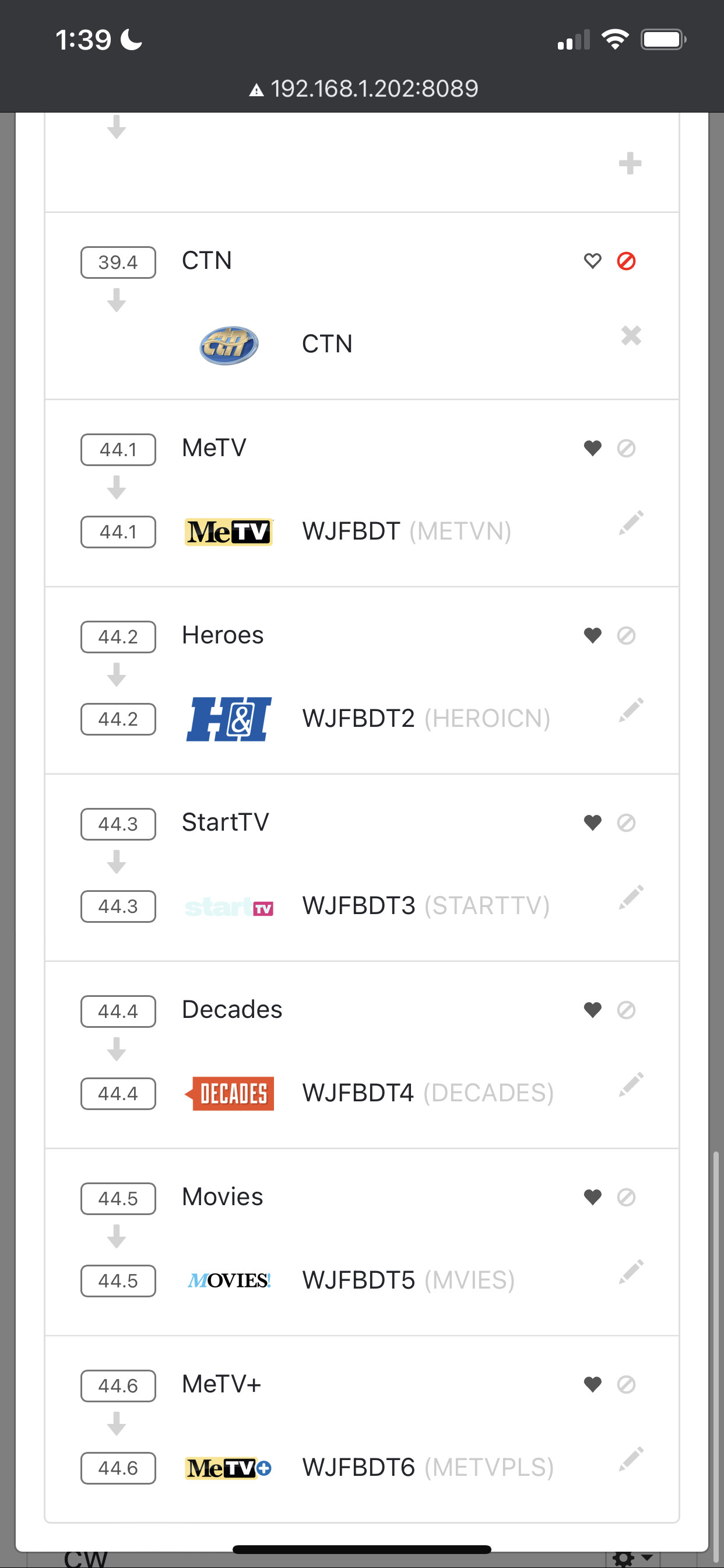

I need to force Channels to try my HDHR3 for MeTV (Nashville, TN). However the scan doesn't classify WJFB in HD. Even though it is, and works fine on my HR4K. The signal comes in better on my HR3, which is connected to my CM3020 antenna. Where the HR4K is connected to a lower, and different direction (for WKRN). I need to know how I can make either Channels choose the channel I Hearted (the HR3), over the HR4K. But because the HR4K says it's HD and the HDHR3 doesn't, it's choosing the HR4K all the time. BOTH are in HD. Is there anything I can do beyond M3U manual linking? Thanks

I need to force Channels DVR to see the HDHR3 WJFB, MeTV as HD. As it is. But it only shows up as SD. So Channels chooses the WJFB from the HR4K, that it can't receive. I can't find anyway to make the HDHR3 see WJFB MeTV as HD like it does with the HR4K.

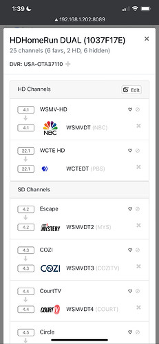

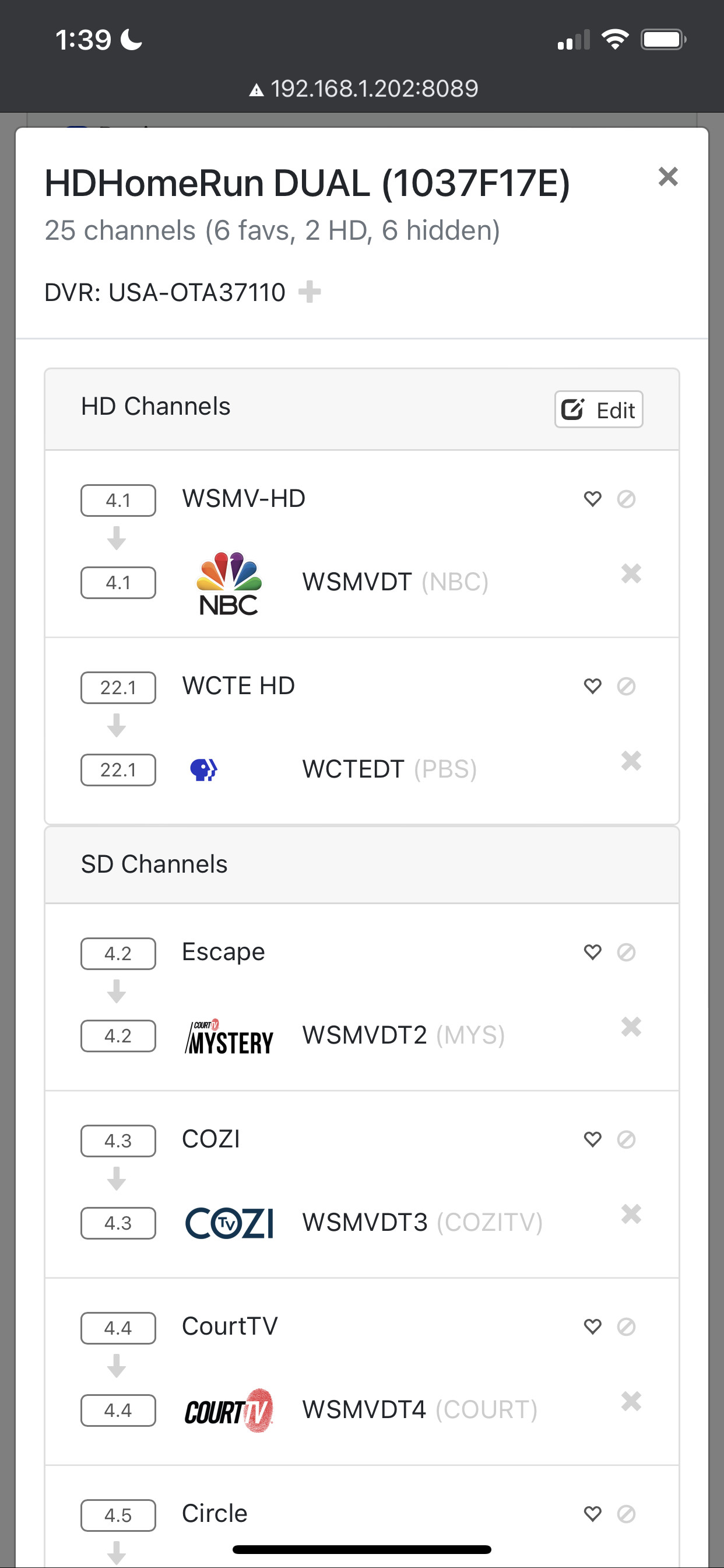

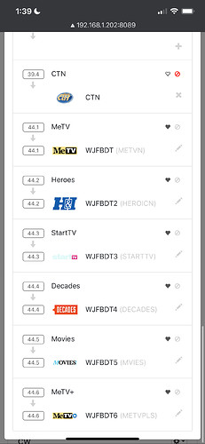

Click the "123 channels" link under your HDHR and screenshot what's shown
As opposed to the 4K
Click edit on the top right of HD
Holy crap. I never even knew that was there. Thanks!
