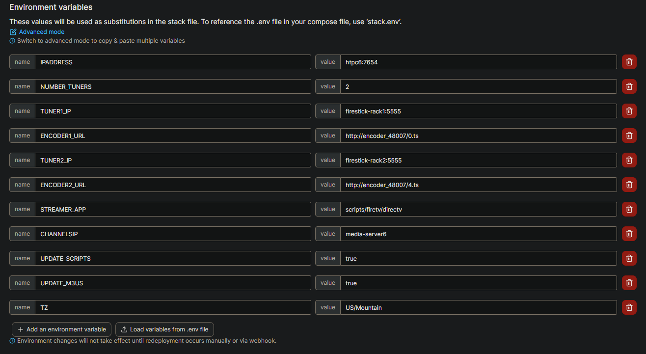

Here's a docker-compose you can use in Portainer-Stacks:

And, some example environment variables. Note you'd want to use /scripts/firetv/dtvstream for your STREAMER_APP variable (there are some slight differences when sat credentials are used, which is why mine is different). Other variables would be set to suit your setup:
