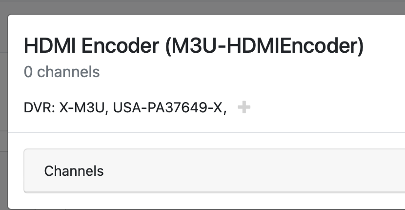

Thank you for that. I feel like I'm getting close, with the ability to send commands manually to change channels, but I've got empty guide data, and my source doesn't give me any channels to add. I've hit a wall and I'm not sure what to tweak next. I've done the whole "go build", have a little exec app that I run, but still nothing.

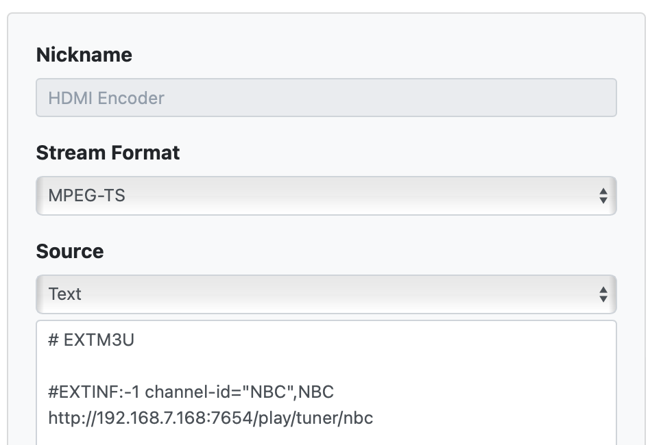

Does the rest of your Custom Channels setup look like this?
Yes, and then for the stuff at the bottom, I copied what you had in your earlier post.
Remove the space after your first #.
