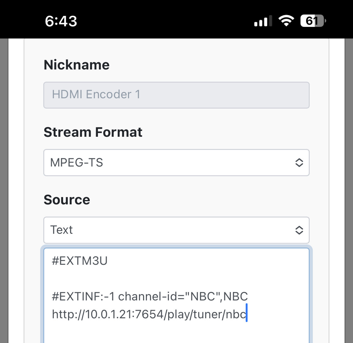

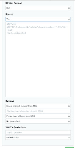

Would someone who has this working be willing to share your source setup? I remember seeing examples for the main part of the window, but not the other parts.
This is the setup and format working for me with Google TV devices and a YouTube TV subscription:
Obviously you’d use your own IP address.

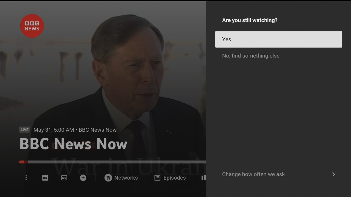

I don't have a solution to your question, but wanted to add this to the conversation, since I did get a chance to see it, at least on the YouTube TV app. When this pops up, the androidhdmi-for-channels script stops being able to change channels in the YTTV app :frowning:

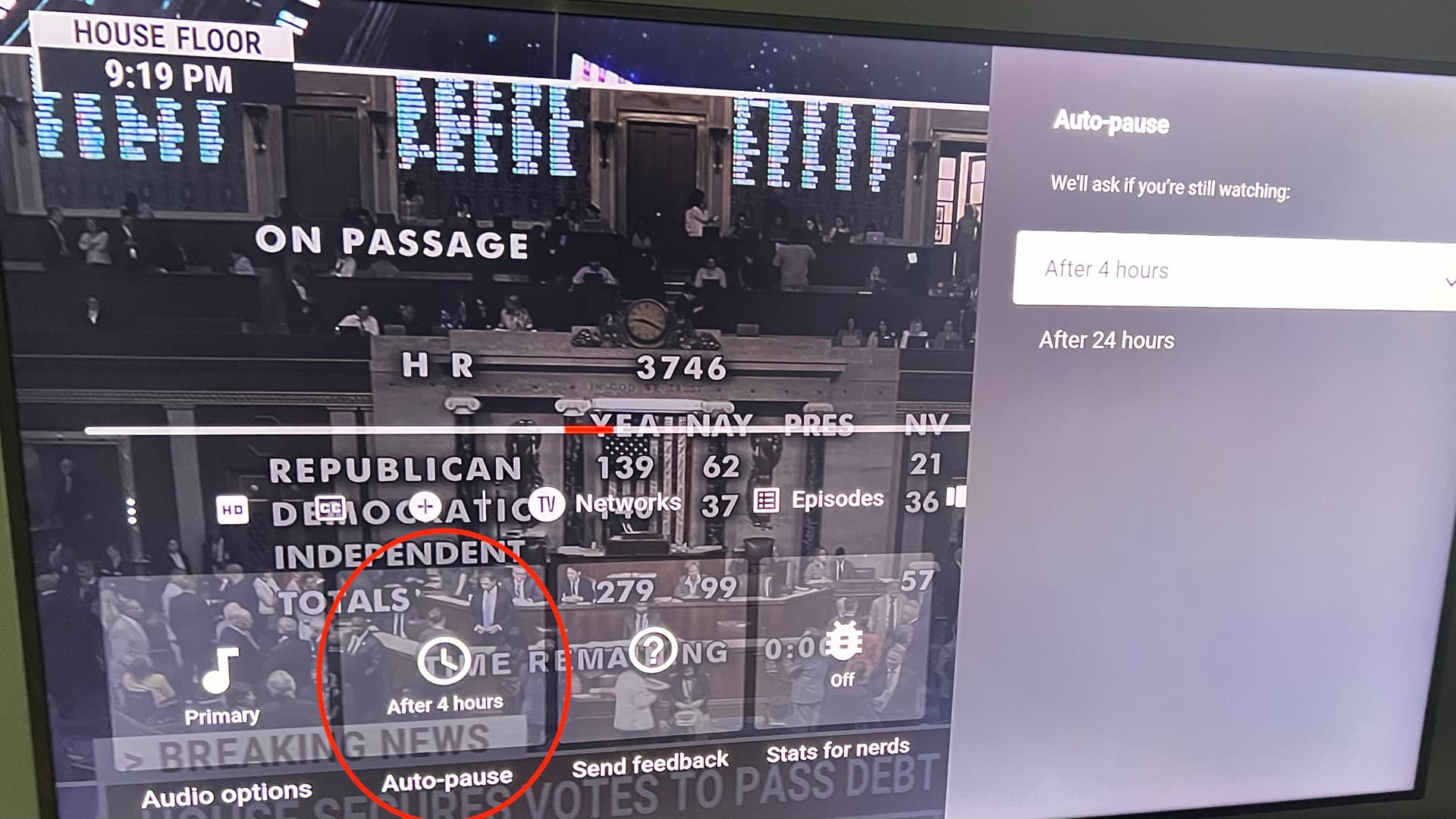

Fortunately there is a setting in the YTTV app, the "auto-pause" can be changed to 24 hours instead. Perhaps DTV Stream has something similar?
