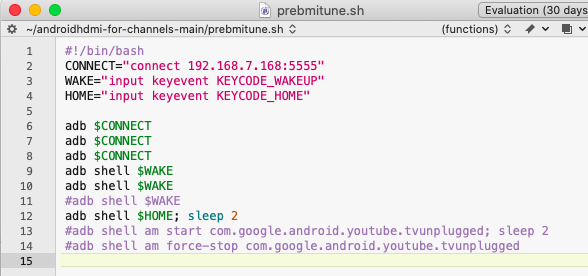

prebmitune
I then rebuilt it, and ran it, and I still get the same "adb: command not found" error in several places (I think wherever I use the "add" command). I'm running this on a very old MacBook Air, running macOS Catalina.

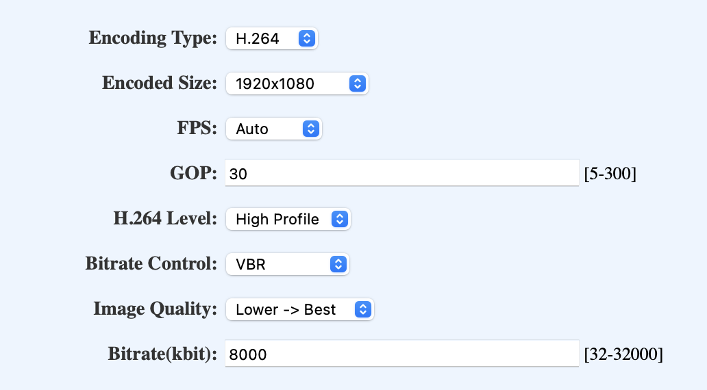

What bitrate and FPS, and I guess other settings, is everybody using on their encoder? I was going with 7000 bitrate (VBR) and I kept it at the default 30 FPS, but things looked… off. Can't quite explain it, but it didn't look entirely naturally. I've turned up the VBR to 8000, and it's helped some, I think. I'm curious if I can go higher, or set the FPS to either 60 or "Auto."
EDIT: one of the settings for FPS was to match the input, so I turned that on.

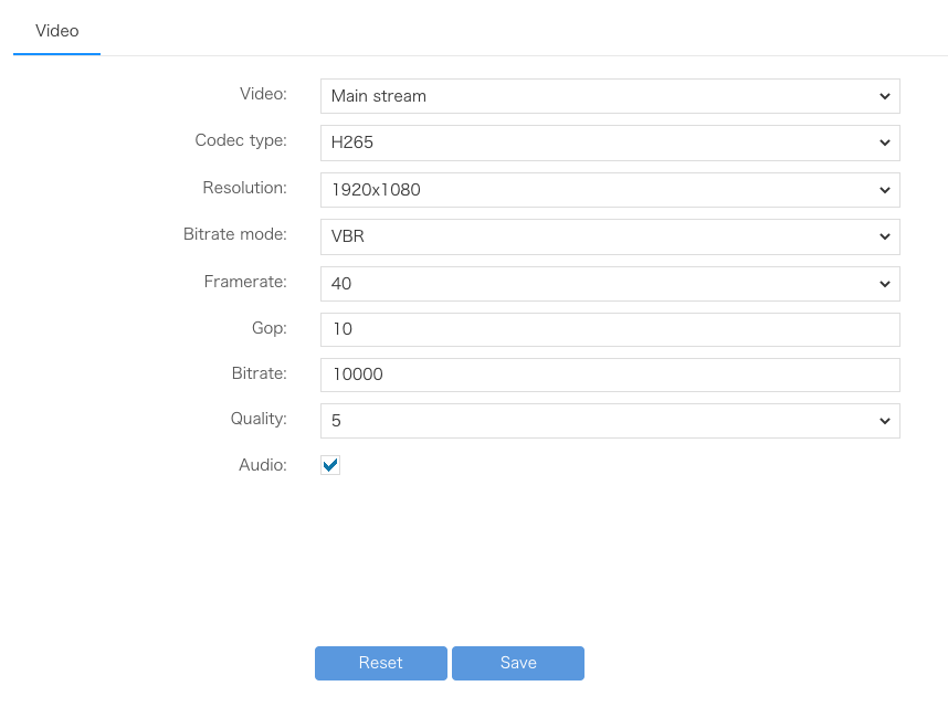

Attached is my settings. Arguably overkill but looks great and haven't had any disconnects. Had loads of disconnects last night while testing H264 but H265 with this combo has been rock solid.
