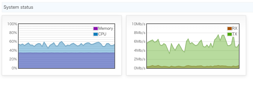

Do your encoders have a CPU and Memory status meter by chance? Curious of how loaded other encoders are when at 1080P/50. Attached is mine for the last few minutes.

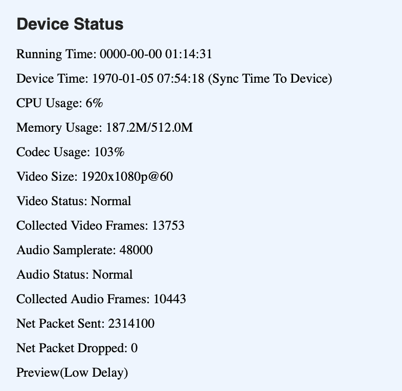

This is all I can find in my encoder's settings page:
I'm not sure if the "Codec Usage: 103%" is something that should concern me.

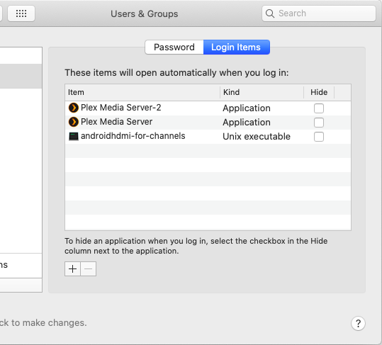

There was some talk about having the androidhdmi-for-channels program auto-launch at login using a third-party app. It turns out that it works like any other program if you add it to your login items if you're running this on a Mac (on an older Mac like I'm using as my server, that's at System Preferences > Users & Groups). I added the executable there, rebooted, and it started up automatically when I logged in.
Screen Shot 2023-06-03 at 7.06.10 PM
