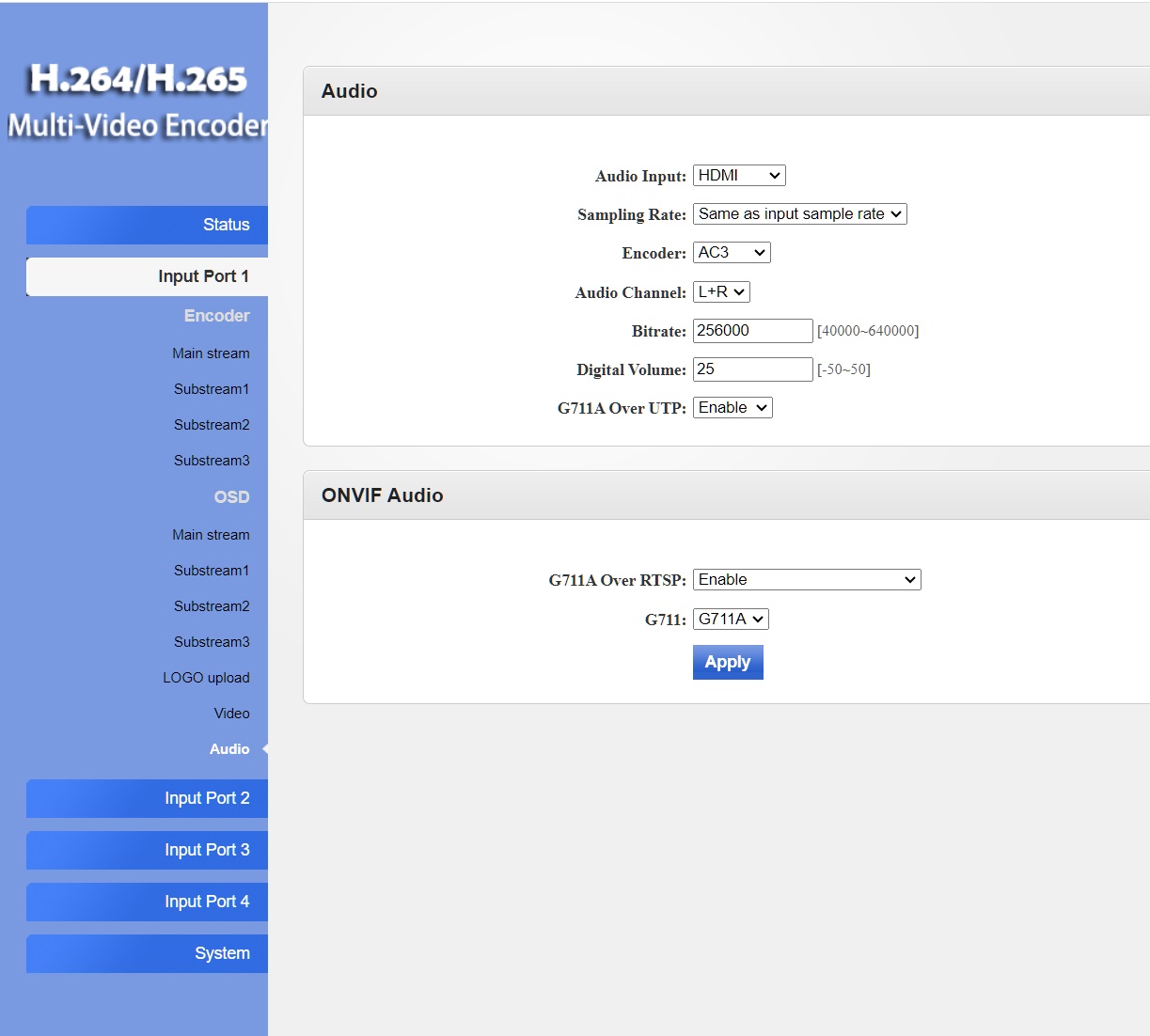

I like to try new things like this, but I must be pretty stupid. Have a Uray encoder and an Onn streaming box, but I am not getting audio. I've tried swapping HDMI cables, updated firmware, changed every setting possible, rebooted countless times, nothing.
Sometimes after a reboot and I do a page refresh it will say audio "normal" and then go away.
Any suggestions? If I can't even get past this first step, forget the rest :slight_smile:
Did you try setting the Audio output to Stereo or PCM on your streaming device ?
There are three options - Automatic (Enable only the audio formats that are supported by your audio output device) - None (Never use surround sound) - Manual (Manually select audio output) and then there's Dolby Digital, Dolby Digital Plus, Dolby Atmos and DTS.
I tried automatic at first and then tried None (never use surround sound). I did not try the others because I thought never using surround sound would have worked.
What device are you using maybe others that have that Streaming device can help. I use FireSticks.
Thanks! It's the Walmart Onn streaming device that I've seen posted here. I tried to use a Firestick to test, but my stick kept crashing.
Before I used my Spare Firesticks I reset to factory settings removed any apps that are not needed.

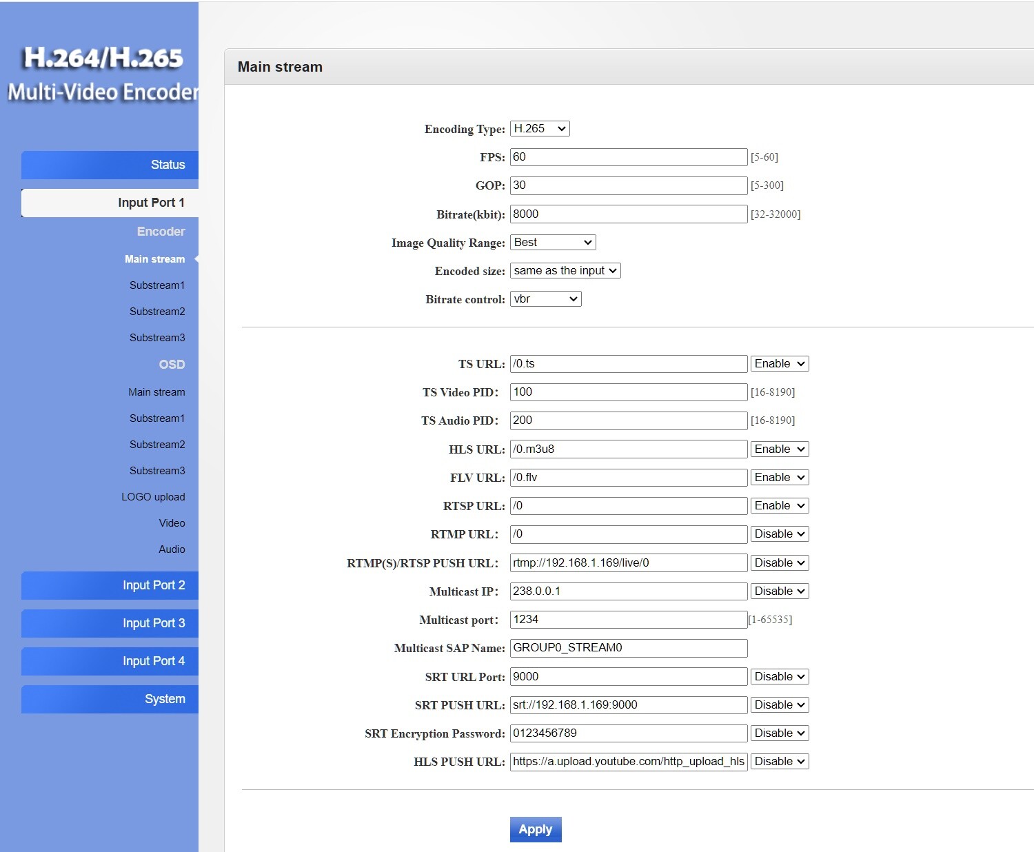

I probably had your setup for a few days (until I switched from the URayCoder Single Channel Encoder to the URayCoder 4K 4 Channel Encoder). It worked out of the box just fine. So my first question is has the audio ever worked for you? Or did you just buy this encoder new to begin this project? Second question would be, does your Onn box send audio out to a TV if you connect it directly to the TV? If the Onn is sending properly directly to a TV then it is most likely sending properly to the encoder.
If it helps, here are some of my setting. I am using an Onn Android TV 4K UHD Streaming Device as my first device. I use Chromecast devices for the remaining devices.
